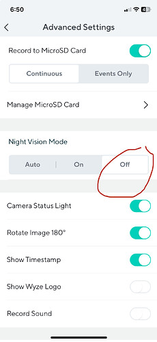

Night colour vision on v3s is better by leaps and bounds than more expensive cameras out there.
Again, if I were you I would check the settings on the camera.
Thank you, I will check my settings, I do already have a night light on the room.
Make sure that Night Vision is OFF, that will turn the IR off and force the camera in Colour Mode. I know it is confusing. Wyze is doing terrible job at graphical interface design.
Good luck,
