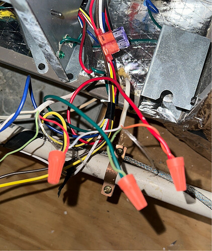

hmm. do you have any pictures? specifically a picture of the wiring at the furnace and the wiring at the air conditioner.

At the AC unit

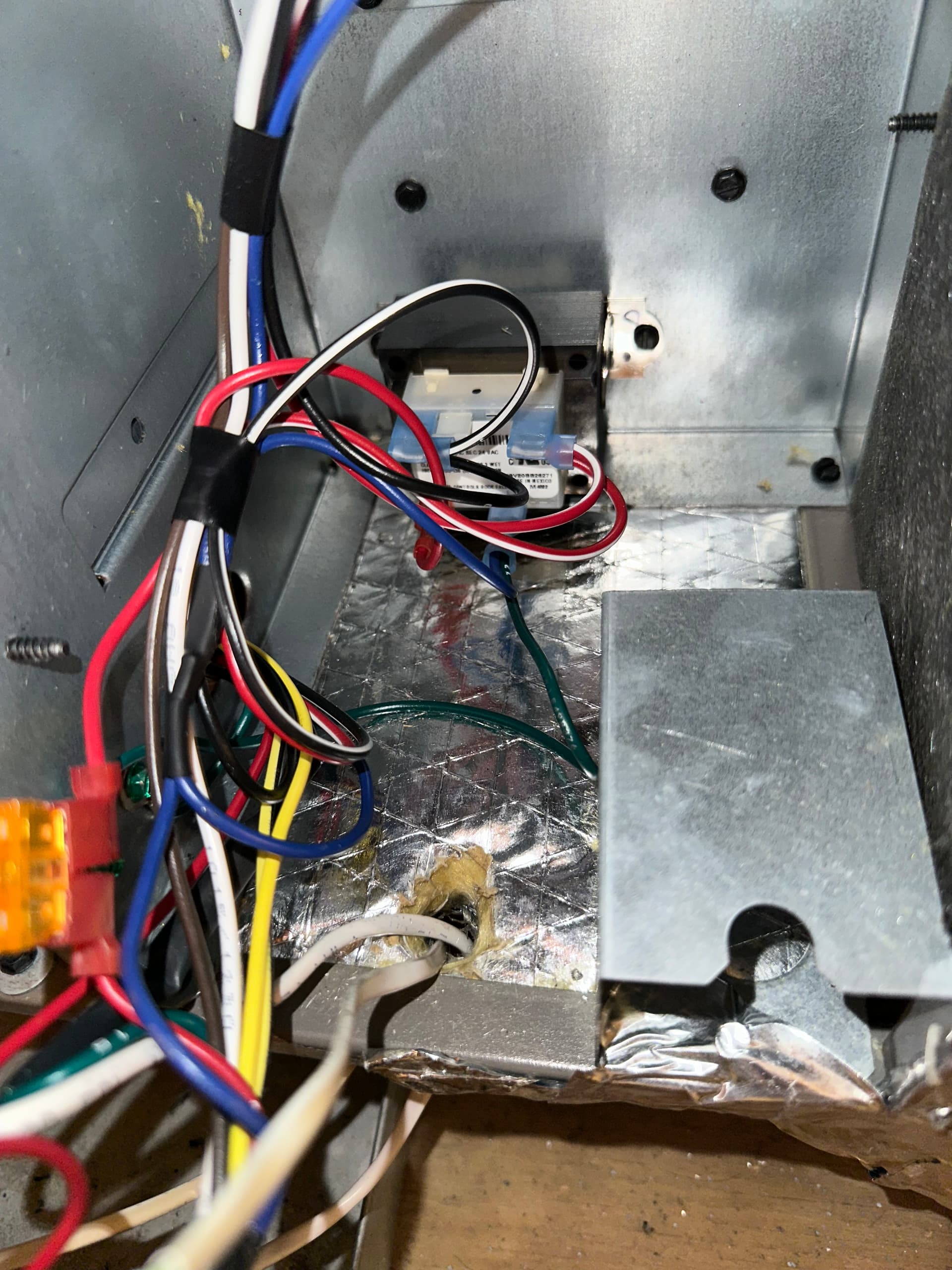

The blue wire in the AC unit goes to the common side / ground of the transformer and the blue wire from the thermostat picture runs to the AC unit. That’s the one that I connected to the blue from the transformer.

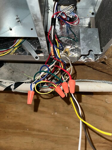

I don’t see that blue thermostat wire in any of the bundles in the A/C unit picture. do you have a picture of it?
So far this is all I see… where does the second wire set that goes to C, Y, and X go?

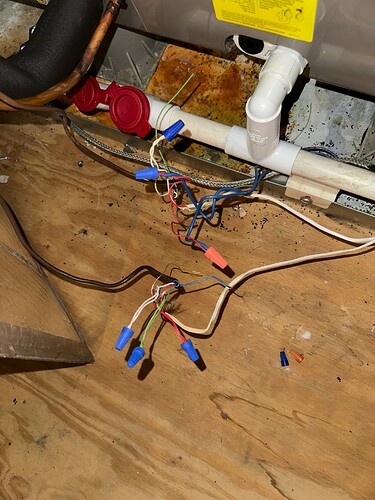

Blue wire is outside of new unit. They ran a 3 wire to the inside
In the first picture from the stat to the AC handler = W to Y; R to R; G to G; blue is disconnected outside the unit
Then from the handler to the outside unit Yellow-black to red; blue to white; green not used
First, I would try hooking the thermostat up at this location, to verify that you have a working thermostat and eliminate the wiring as any sort of fault.
The two red/blue Y wires are a float switch that turns off the compressor if you have a clogged condensate line, you can ignore them for now.
The thermostat only needs Rc and C connected to power up, try that first, and if it still blows the fuse, you have a faulty thermostat.
If the thermostat powers up here, then disconnect it, reconnect the wire nuts and connect the blue wire here to the C wire nut in the picture.
If you have a multimeter, check the voltage at the thermostat. The blue wire should now have around 24-29 VAC between it and the red Rc wire.
If you hook up the thermostat at the thermostat location after doing these tests and verifying the voltage, it should work, and not blow the fuse - if it does, then the wires likely have bad insulation which is shorting out when you push the wires back into the wall after mounting the thermostat backplate.
