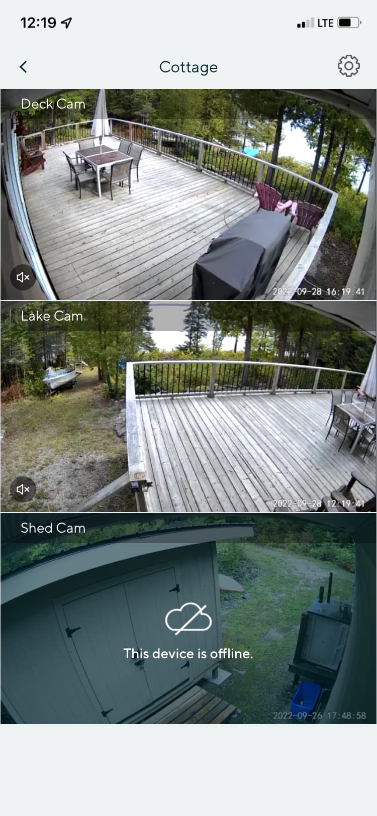

I have three cameras on a remote location set in a group. All three cameras are powered through a Kasa TP-Link plug, so when I need a hard reboot I can supply to them. Here is the issue, Two out of three cameras work perfectly, no issues whatsoever. One, not so much. I get the following:
Here is the conundrum. all three cameras are on the same network and the camera in question is the closest to the router, so no network issues, right?!!!? Or am I missing something?
So when I go into my group, I see two cameras working fine, the third one not so much.
So, what is going on? Don’t tell me there is something wrong with my network? I don’t buy it. This has to be Wyze!? I know it doesn’t make sense, but what else could it be?

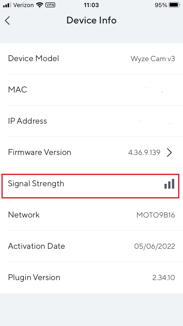

The most weirdest part is that I can reach out to the camera and see the info (via app “Device Info”) so the Network is not dead or an issue.

Can you verify the Kasa plug its on is powered? Have you tried power cycling it via that plug?
The Kasa is on, hence the cameras (at least two out of three supplying live feed and recording to SD card). Remotely killed the power to Kasa plug and two out of three cams are coming back online. Is my cam dead?

You said you can see device info. What does it show for signal?

Not sure if this is accurate but this is what it showed last time. Used to be three bars and now is two only. Still, don’t get why it will show local network and not remote especially when two other cameras are fine and happy :slight_smile:
