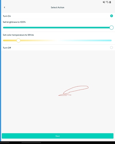

Yeah, there is. When I schedule any bulb to come on by Rules, I can also “program” a temperature (aka color) and brightness.
When I select the bulb to turn on…
It allowed me to set the temperature and brightness…
Try to post some screen shots of what you’re seeing.
Where your screen says Next, my screen said Save.
I upgraded firmware on my bridge and now I get the temperature brightness settings after hitting save, now says next. Thinking this may have been the problem. But it works now.
