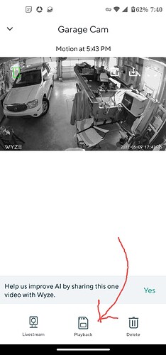

This is very upsetting. I paid for the camera so it’s mine right? I paid for a 32gb sd card to save my own videos too so I didn’t have to sign up for service. However, after the last update I no longer have access to MY OWN sd card for video. A triggered event only takes an image now. When I try to change it to video it doesn’t take my to my sd card for storing, it tries to sign me up for service. Essentially, you reached right into my camera and took the SD card out with your update. I don’t care about Cam Lite - it’s still cloud service. I want to be able to use my sd card with a slot you provided and I paid for. Service should always be optional - not forced and the fact you had an option to store locally on the device is what enticed me to buy your product. Are you going to fix the issue for Camera users that have sd cards? Am I out of my lane here and spouting off or is their something I’m just not doing right?

I have mostly V3 cams so that is all I can reference. If you have a WCO (Wyze Cam Outdoor) everything below changes as these operate much differently. If you have the WCO, let me know and I can send you to a user who knows them. The recording did change and there are MANY topics discussing it.
From what you have posted, it sounds like you are not signed up for any plan subscription. On the basic\no subscription plan it will show only a thumbnail image in the Events Page and you cannot change it to Video. You ONLY get a thumbnail. This was announced a long time back with the introduction of CamPlus Lite.
If you sign up for CamPlus Lite or CamPlus, you will get video. You can sign up for CamPlus Lite and get 12 second videos or CamPlus for full length. There is still a cooldown in CamPlus Lite. Again, many topics in the forums discussing the changes to this 4 tier plan structure and how it affects users.
Basic Plan, Cam Plus Lite, and Cam Plus do not affect the uSD recording. (If you have a WCO… I know it was affected, but I don’t have details)
When you select an Event in the Events Tab, those are images from the Cloud, NOT the uSD card, Regardless of your plan subscription level. Opening this event in the app opens the Cloud Image, not the uSD video.
In order to get to the uSD video from that event image, you must press the uSD Playback Button:

Hope this helps. Please post back with details on the type of Cam you have and the specifics of your uSD settings (motion vs continuous) and how you are trying to access the uSD video. We will help if we can or find someone who can. If you want, feel free to Private Message me on the DM!

Thank you very much for the help and for taking the time to do so. I have a Wyzecam v3. I was able to locate the playback button. I was so frustrated I just didn’t see it. I’ve never had service - just the uSD card and playback was always initiated by an event screenshot and just pressing it so this update switched operations around on me.
