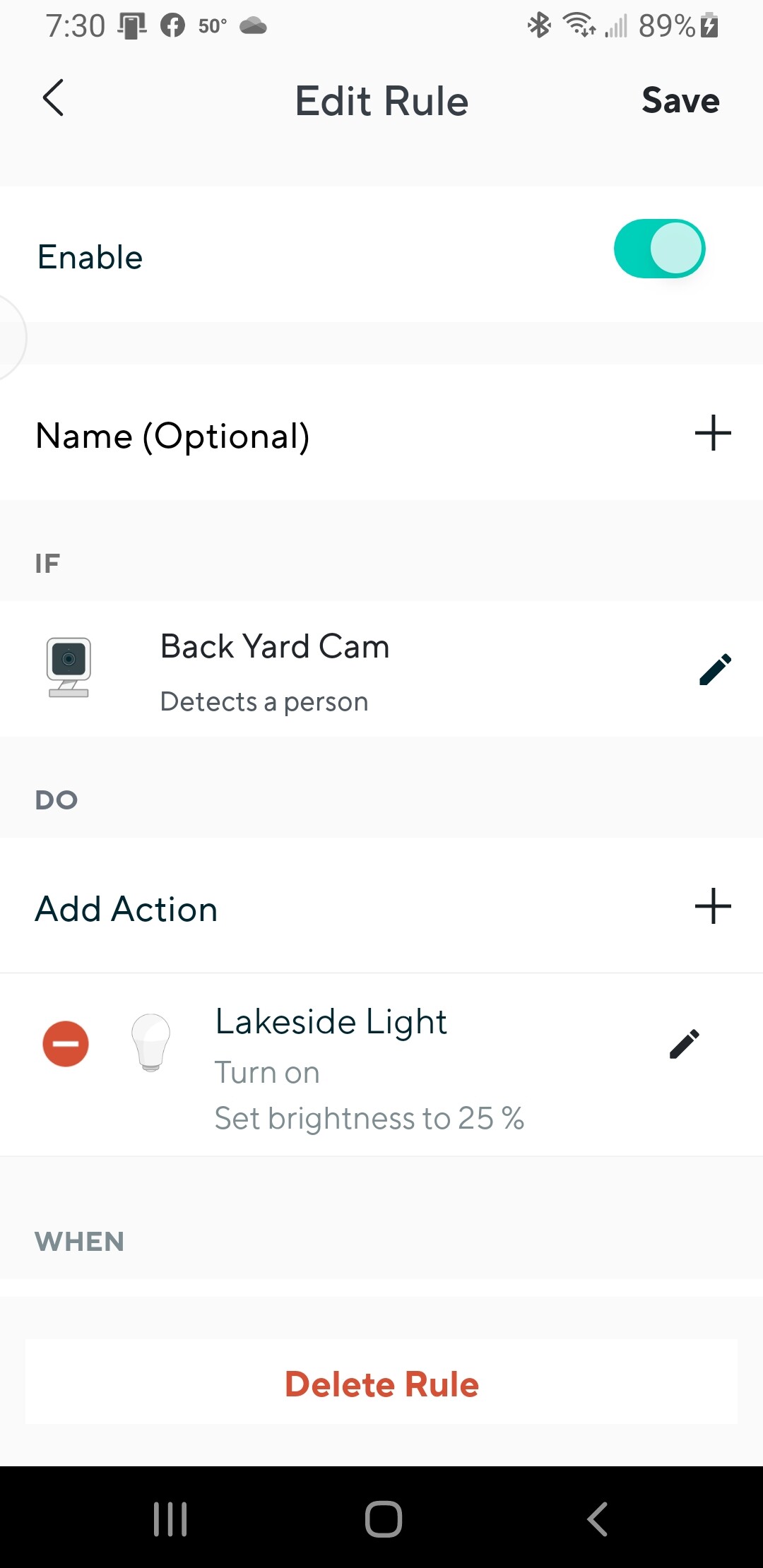

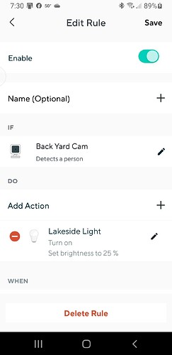

  3. Under device triggers; I have a rule if this Cam detects a person, turn on light in lamp socket for 30 seconds. (Will this work, or does motion setting have to be on?)

Can you post a screenshot of what the rule is now? The rule is now? Is your rule currently that if a person is detected turn on the light? Using the person trigger should eliminate the just bug movement detected event videos unless there’s also a person detected in that frame somewhere.
