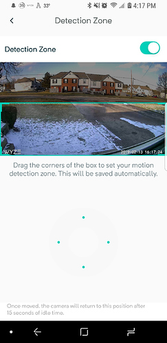

I have my pan cam pointing out my front window at my driveway, walkway, and yard. Unfortunately the camera also has a great view of the road, so whenever a car drives by, I get a notification. I’ve tried turning down the detection sensitivity, but that only causes it to not recognize motion right outside the window (the lowest I’ve turned it down to is 35). Because of this, I tried to set a detection zone, but I noticed when I do that, the camera goes right back to the default stationary position after 10 seconds and it completely voids the whole point for the detection zone. I am running on the beta version, so it’s entirely possible this is a beta bug, but I wanted to mention it anyway.

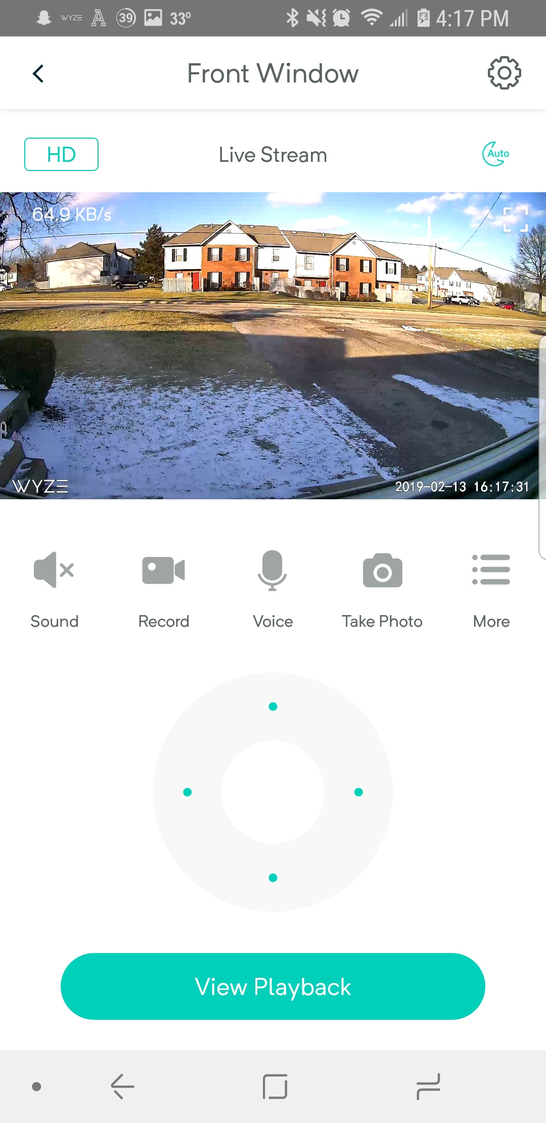

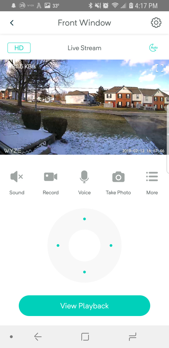

The first screenshot is my detection zone, the second screenshot is the camera right after I apply it, and the third screenshot is 10 seconds later without me moving the camera at all.

Read the fine print at the bottom of the first pic you posted.
The camera returns to it’s home position 15 seconds after you move it.
I just tried setting mine at a position off center and it keeps returning.
It appears to be by design. I don’t know why.
If that’s the case, they may want to re-word it. When I see “the camera will return to this position,” I read that as it’ll return the camera to the position I set the detection zone to if I were to move it away from the zone. Basically if set the detection zone in one spot, then moved the camera to the left a bit, it’d automatically move back to the detection zone after 15 seconds.
That was my assumption too and that may be what it’s supposed to mean.
Someone from Wyze will let us know.
It is supposed to return to the detection zone position, not the default position.

I find that I first set my home position under pan scan settings. Usually I only have the one setting which is where the camera is to return to if I ever change the position. I also find that I have to reset the alert zone if I change the pan settings.
Yes, Pan Scan and Detection Zone are mutually exclusive. When you activate one, the other will be deactivated automatically and a message to that effect will pop up in the app.
I think it’s a bug in your beta firmware.
On my Pan cam (with production firmware), I have specified the desired default location using the 4-way controller on the bottom of the Detection Zone page. (NB - on my version of the iOS app, the 4 control dots are grey. On yours, they are green so it looks like Wyze has been working on this part of the GUI). Once I have specified the desired location, then I adjust the size/location of the detection zone. Having done so, if the camera position changes (either manual control or via the motion tracking feature) the camera always returns to the location that I had specified after 15 seconds or so.
Note that in the current production code, it is not at all obvious that the 4-way controller at the bottom of the Detection Zone is live. At present, it’s grayed out, making it look like it’s non-functional. As a result, many people overlook the step of pointing the camera to the desired location when on the Detection Zone screen.
I think it’s a bug, as well. I was able to temporarily work around it with prley’s suggestion. I set a manual waypoint under the Pan Scan settings, then setup the Detection Zone and now the camera goes right back to where I want it. Hopefully they’ll be able to fix the bug soon, but it’s nice to know there’s a workaround if it takes a while.
