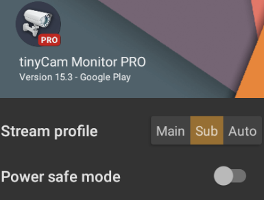

If smooth, quick image display during NAVIGATION (between cam groups and individual cams) is the priority, change the stream profile to Sub:
The Auto profile - switching between 360p & 1080p automatically - which is what the Wyze app does (robustly of late) causes me the most tinycam crashes, whether within Bluestacks or on tablet. :man_shrugging:

Swipe-in the main program menu from the left screen border and change Stream Profile from Main to Sub. Play and observe basic performance for another good while. Try the ‘Auto’ profile setting, observe.
