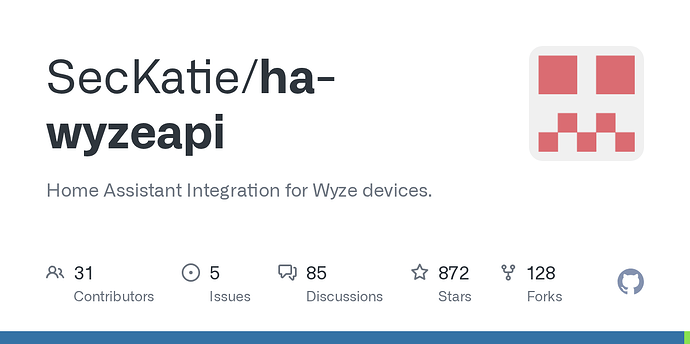

Seckaties Haos integration doesn’t expose Wyze sensor, they’ve know of but double check on GitHub. I don’t have Wyze sensors.
There are some older Haos integratios around if you search.

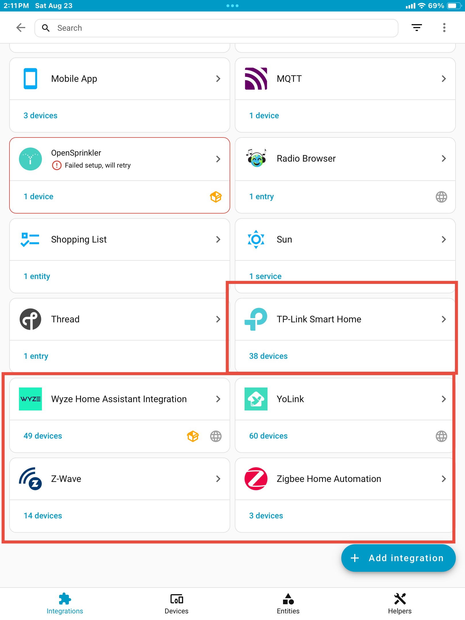

My environment is diverse. Wyze, YoLink, TP-Link, Z-wave (plus others) unified, to some extent, using Home Assistant. HA allows me to use switches, sensors, plugs, etc from various manufacturers. I use YoLink motion detectors to activate Z-wave switches and Wyze bulbs. I don’t have any cameras linked to HA, but don’t really need them. Also us Alexa to announce person detection events from cameras.
Wyze can’t really do everything…
