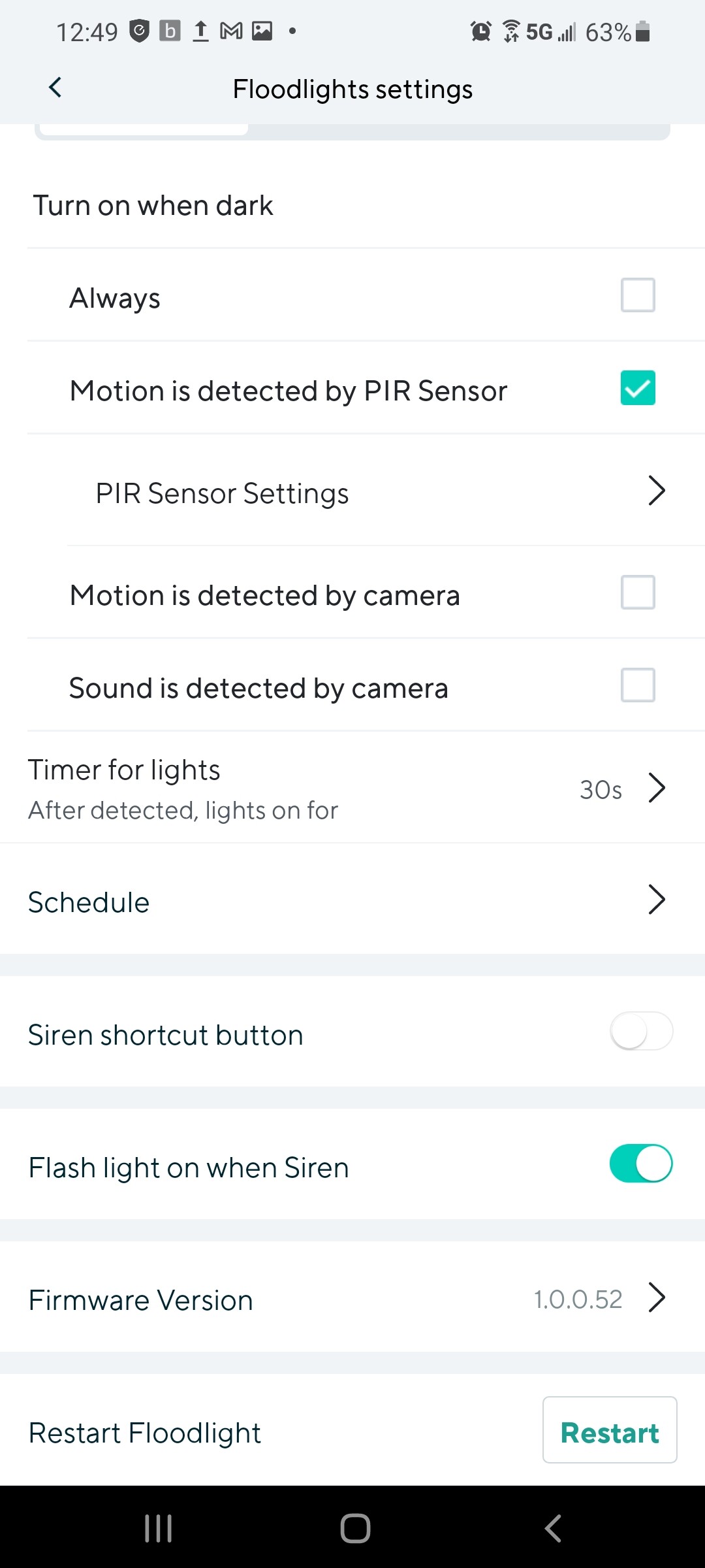

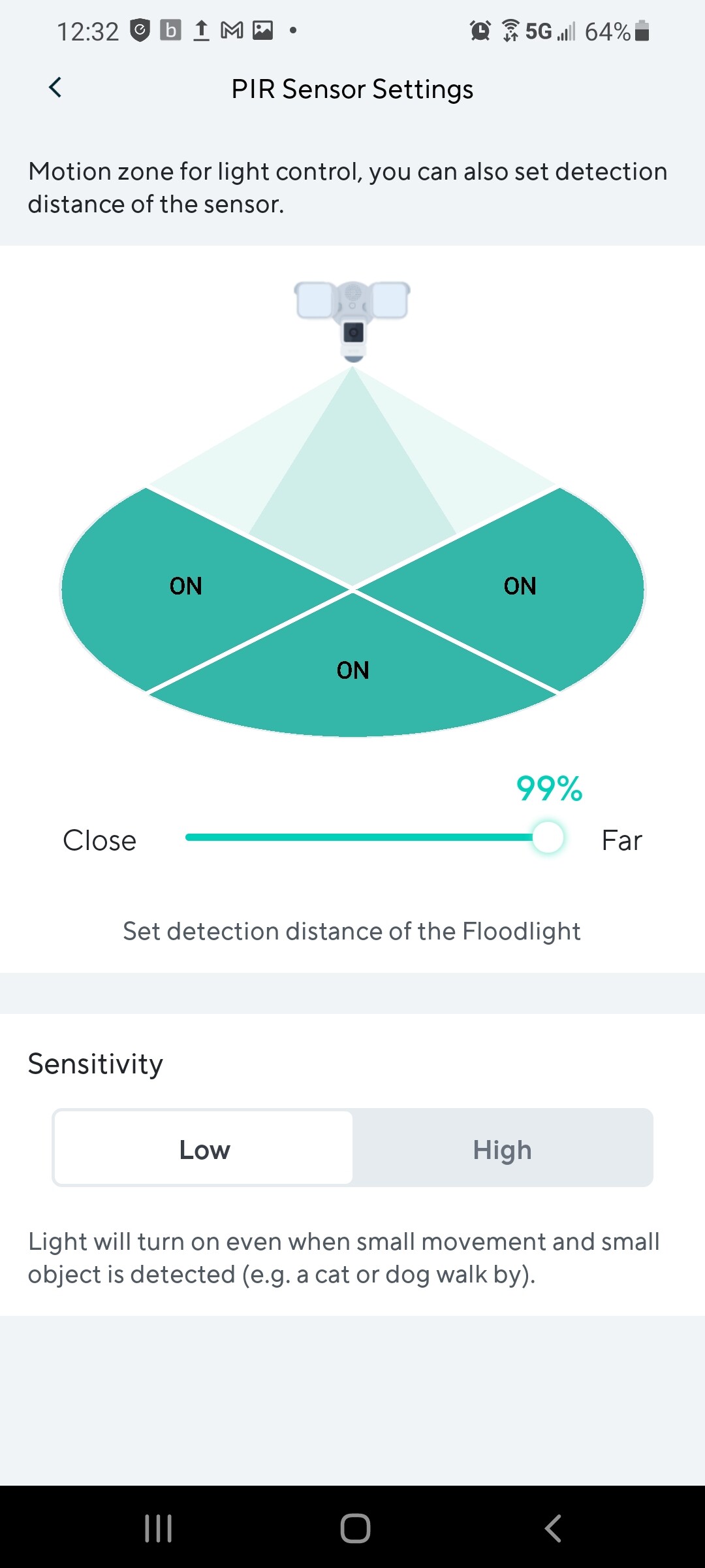

Can you control the lights at all from the app? From Wyze’s installation video, it looks like the only control you have is over the camera. I want to be able to turn the flood light on and off and adjust brightness through the app.
The answer to your question is already in this thread scroll up
Is it the comment that says this is just a motion sensor flood light with a v3 stuck on it?
Two days ago didn’t someone post a screen image of the app menu that controls the flood light settings?
You can control the lights from the app take a look at the screenshots I posted here, post 54 they show the controls
