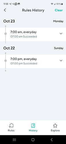

Here are the screenshots you requested. It will only allow obw at a time.
Those all look good. The rules Hx matches what the rules are supposed to be doing.
