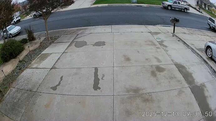

Are you able to use a wired Wyze camera looking out through a window? Here is a picture of my v3 over looking my driveway through a double pane window. With Detection Sensitivity set at 90, I get Notifications of people walking on the sidewalk across the street.
