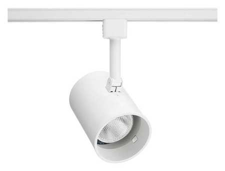

I’ve got track lighting with metal “cans” like
