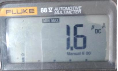

I also measured the amperage draw of the contact sensor .
I found that it draws about 14 mA when there is a state change ( Contact open or closed) for less than 0.5 sec.
They draw only 1.6 Microampere µA when not broadcasting a state change . It draws the same if the contact is open or closed.
I am not sure what the draw is when it broadcast a heartbeat message or how often it broadcasts this message . I assume it would be the same 14 mA .
