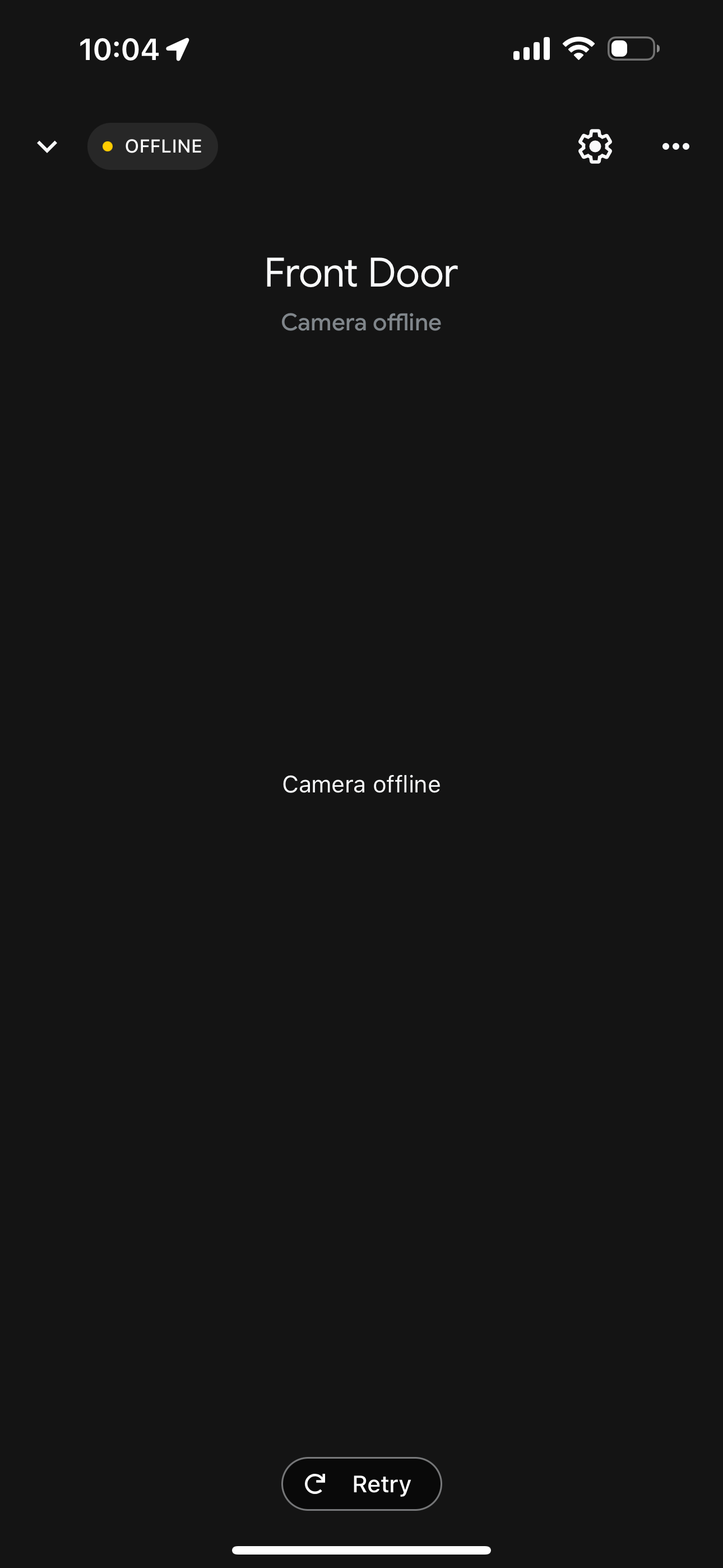

I am having the same issue. Have an Iphone 14pro max, using Google Home, and have 8 Wyze Cameras, ranging from V1 to the newest Wyze Pan Cam.
I am unable to view live feed of my Wyze cameras on Google Home app or Google Chromecast devices. I am successfully able to tell if a Wyze camera is not connected or powered on via the Google Home app. That indicates to me that the issue is just streaming via the Google Home app.
I have tried to Unlink Wyze as advised, and set up 2 factor authentication, and relink, i did this 3 times. Ensuring I am closing both apps after each step. And issue persisting.
I have also done a factory reset on my home wifi router, and also disabled the Simultaneous Dual Band, issue is persisting.
Any other recommendations?

none of my cams work on Google Home app yet for iOS in Canada. I have contacted Google support and have heard nothing back from them re: them working on it. As per my previous posts, my plugs & lights work fine so I am connected (linked). but stream is a no go…
I’m in Canada and wondering if this has something to do with why I can’t get any of my Wyze cameras V3’s or OG to connect to my Google home screen to view them.
All I can do is view them on the Wyze app on my iPhone.
But I was hoping, and I was planning to be able to view them all on my Google Home screen in the kitchen. But every time I try to view them, it says “can’t reach this camera”
I’ve tried removing and reacting all of them. I’ve tried to factor, I’ve tried racing my account and creating it again. I’ve tried indirectly using different apps to access it through Google. I’ve tried voice recognition to get it to show up. I’ve tried every tip and trick I can find on every forum.
But nothing works.

I’m having the same issue with my google home connection, everything works fine with the switches, lights, and plugs, I can even turn on and off the cameras, but I cannot get them to stream to the Google Hub or to any chromecast device, not even on my phone. Streaming works fine on the Wyze app. This is getting to be very annoying since I was trying to automate the door bell camera to show on Google hub when the doorbell button was pressed. Wyze should be working more on this.
Same issue with the V3 here. I have a Wyze doorbell Pro that works fine & another V3 that works fine. One thing I haven’t heard from others is in the Google Home App (on my Android phone & Google Hub) under devices the offending V3 is a different color icon. All my devices are a black box, the V3 with the issue is blueish grey. It is there, when I click on it is just says connecting but I can click on the gear and access the settings. It’s baffling that I can access the camera’s settings but not stream. I have tried all the attempted fixes on this thread multiple, multiple times
