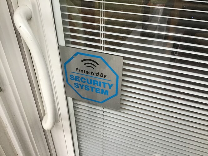

Sorry for the thread drift… Wyze doesn’t sell additional stickers. There is a wishlist topic requesting stickers and yardsigns, but if you’d like additional stickers now you can order via Etsy or Amazon:
Wyze:
Generic:
https://www.etsy.com/search?q=security%20stickers
https://www.amazon.com/s?k=security+stickers&crid=12TDIQ4QZ9XLE&sprefix=security+stickers

The OP did consider the advise of not advertising the brand of the security system and said they would go with generic security stickers.
