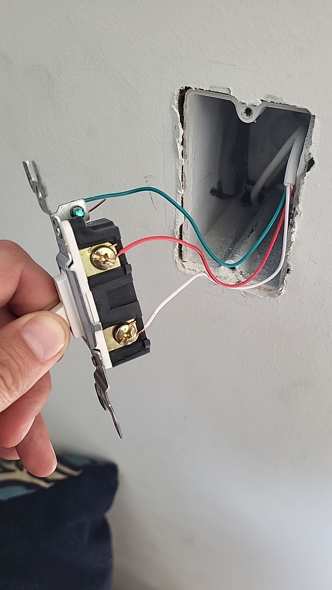

Since power is ran to the fireplace, and a light switch is attached to that, there is no Neutral wire in the box… I think I could maybe feed a wire up to the box, does anyone else have experience with this? Before I attempt this, I am wondering if it will still work? Could I pull through another strand of wire, that has 4 wires?
Based on the picture below, if the whole reason for a Neutral wire is to power the Wyze Switch, could I run a cable with Red, Black, Wire and Green? Then the Red could be Line, Black can be Load, Green will stay ground, and White would turn into Neutral, but I could try to tie it into the wiring by the fireplace unit? My concern would be the difference in wire gauges…. The fireplace has 14-2 Romex ran to it. In the picture below, it looks like 16… Likely a proprietary(or kit) switch and wire for the fireplace? Which, if I ran 14-2 romex up to the box, Maybe I could connect the white to the main Neutral at the fireplace base, and the Wyze Switch can handle that, so I don’t have to twist different sizes together?

Are you certain that this switch is connected to household current? That doesn’t comport with my understanding of how these things work, though I haven’t actually pulled the switch for my gas fireplace and tested the wiring myself. If I did, then I imagine I’m not going to be measuring anywhere near 120 V AC. (I don’t mind testing if that helps with your question, as it could satisfy my own curiosity.)
If the wiring in your photo doesn’t look like the wiring you see connecting other switches in boxes in your house, then I think that provides an important clue that this is a different kind of entity and routing a different kind of power. The wires in the photo appear to be a much smaller gauge than I would expect for household current, and I have strong doubts that they would meet code for that application. Given that, I also have doubts that there would be sufficient current into this box to even power a Wyze Switch.

You make a good point! I just tested the wiring to the current switch and it reads 5.9v when off, and 0.0v when on. And i’m on ACV 200 setting, not 750 setting… Regardless if the fireplace is still clicking to start the fire, or if the fire is going and the clicking has stopped.
The smaller gauge wiring and the red, white, green wiring colors was a clue!
I think the only way that could make this work is if I left the current switch always on, then added the Wyze Switch before the fireplace, which has romex 14-2 going to it. But, that seems like a pain… I’ll wait and use it when I add an electric fireplace to the bedroom.
