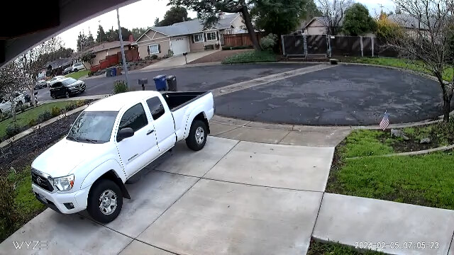

The firmware .8391 showed up for my V3 Pro this morning so I updated the cam .It did not reboot so I had to do a power cycle to get it back on line Now the cam is all out of focus, with wavy lines in live view. Another Power cycle did not fix the issue. I checked the recordings on the SD card after the update and they are all crystal clear.?
I am using iOS. App is 2.49.1 (1) Live view photo.
proc
I am noticing out of focus with wavy lines on one of my v3 cameras in Live View only just like you describe. The rest of my v3 cameras are fine. All v3 cameras are on firmware .8391. Live View is out of focus on both IOS 2.49.1.1 and Android 2.49.1 (390) Apps.

Fixed: I changed from 2K to SD to 360 then back again. All back in correct focus again.
I just realized both the v3 and v3 Pro firmware both end with .8391. My out of focus camera is a regular v3 on firmware 4.36.11.8391.
The latest v3 Pro firmware is 4.58.11.8391. Maybe with the numbering so close the out of focus bug might be why the Pro and regular v3 are both affected.
Also, my out of focus v3 is the camera with the weakest WiFi signal. Could be the new firmware does not like a less than strong WiFi signal for Live Streaming.
Have you tried going from HD to SD to 360 and back to HD and see if anything changes on the V3 ? As I said going through the cycle 2k>SD>360 and back to 2K worked for me. The Pro is back to normal.
Yes, that does clear it up for me to cycle through and go back to HD. I like to leave this v3 on 360p because of the weak WiFi signal. Once I go back to 360p it get fuzzy again.
