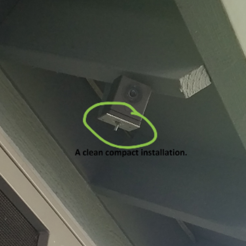

Nice. …now can you share how you mounted this cam, hardware, backs side pics? I’m curious to see how you hid the usb cord as well. Thanks
Yes I’m curious as well…especially on your drip loop. Two of ours installed under similar width eaves and outer casings still get wet occasionally. May not be an issue where you are though.

If you search Victor Maletic on the forum and scroll down to 'Installing WYZE Cam outside- one approach ', you will see how the support bracket is made from a 12"x12"x2" sheet metal angle. The angle is cut down with a hacksaw and bent in a vise with a hammer. Dimensions and bend angles to fit your situation.
The power cord is not protected particularly well. Could be duct-taped along the edge of the support bracket.

The protrusion on the bottom of the camera support is a fake screw - not drip loop. I have not had any issues with water.

I forgot to mention gluing or taping on a plastic shield clipped from a food container.
It should not extend more than 3/4" beyond the camera’s front face. The back edge of the shield should extend far enough to protect the USB plug.

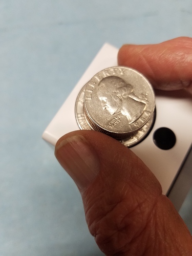

I saw a reference by @LRHowland to an earlier submission of mine ‘Easy Black or any other color V2’ dealing with painting V2 cameras. I got to thinking about how I could make the US 50¢ coin masking of the camera lens easier to use. I increased the mask weight by gluing 6 US 25¢ coins on top of the 50¢ piece. Instead of quarters, you could use some 1” ⌀ steel washers. The quarters provide a nice handle for placing and adjusting the mask. See the pictures below. Also, the small black disk below the camera lens is non-functional in the V2 and can be painted over without affecting the camera’s functioning.
I used wood glue, caulking could also work, maybe even the right toothpaste.
The quarters serve as a nice handle for fine-positioning of the mask.
The mask is positioned. Notice the even black halo around the 50¢ piece, also the light sensor and mike hole are masked as well as the lens.

Clever idea!
