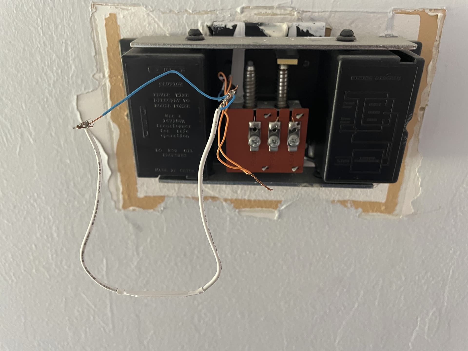

I measure ACV and I got nothing from the cables connected to doorbell
Here is what the connection at the doorbell looks like
remove the fuse and check for voltage, very possible it’s blown
Can I bypass that white cable and connect the 2 blue ends just to check power?
yes
