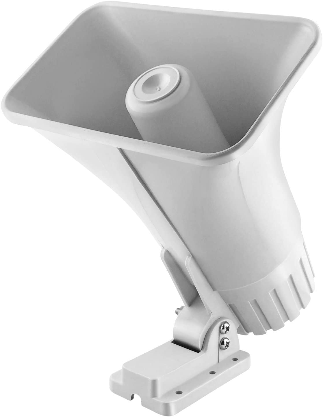

Amazon has a few sirens available that would work with the Wyze plug. The power supply has to be purchased separately.
https://www.amazon.com/dp/B00JRX360W/ref=cm_sw_r_cp_tai_icodFb64M57HY

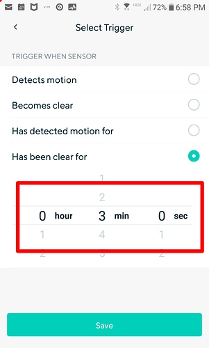

You actually can turn off the plug after a certain amount of time. Select trigger (Has been clear for) in my case, three minutes. Delayed off is easily accomplished.
You have to setup two rules to make it work. I have mine setup this way and it works perfectly. I have my Wyze plug set to turn “off” after motion clears on my motion sensors after 3 minutes.
This is accomplished by the second trigger that turns the plug “off“ not the first one that turns the plug “on”.

BlockquoteYou actually can turn off the plug after a certain amount of time. Select trigger (Has been clear for) in my case, three minutes. Delayed off is easily accomplished.
Trigger>>has been clear for>>
Technically this has nothing to do with turning off the plug after a certain amount of time, or how long the Plug has been turned on. Instead of relating to the plug it relates to the sensor.
