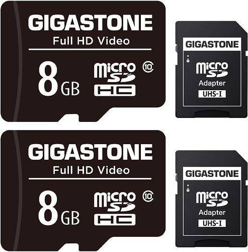

:open_mouth:, do they still make them at that size?
You can find plenty of 8 GB SD cards on Amazon.
All of my SanDisk 32GB cards are High Endurance. The 8GB is not High Endurance, just an old card I had laying around. I put it in my problem camera because all SD cards have the “Micro SD Card Not Found” error whether High Endurance or not.
