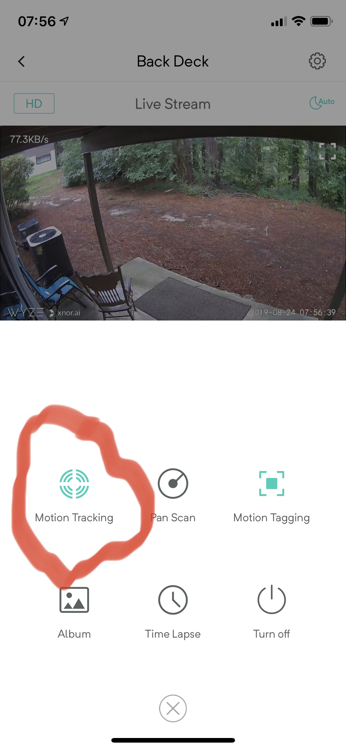

While you are in Live View on the app, press the “More” button, then make sure that Motion Tracking is selected. (The text will change from black to Greenish). It will also enable motion tagging.
This will enable the camera to follow motion.
yes both motion tracking and motion tagging are on. it does not budge when the detection zone is on. its ok to pan if i remove the detection zone with pan scan on. any more tips:)
