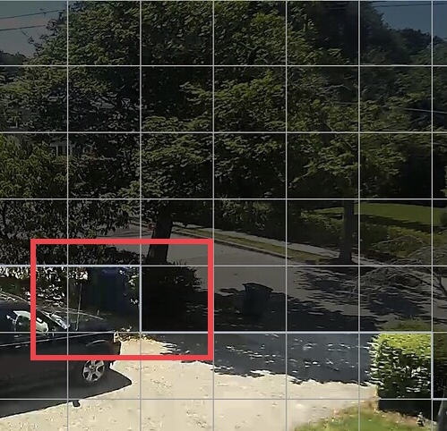

In my experiences a while ago, considering I don’t use the motion tagging box now. I found that because the motion tagging box is bigger often times than what is actually moving the green square will often times go into an actual box you want for detection and that in turn actually reads the frame as if there was motion because of the Green motion tagging box. Keep in mind I don’t use it anymore and that was quite a while ago back when the grid detection was brand new. I would turn off motion tagging and see if that helps you
My camera overlooks some plants that are blowing in the wind today and are completely outside the detection zone but are setting the motion sense recording of events off every few mins

I just tuned in to this - late to the party- but it does look l like there is just a small amount of area out of your enclosed zone which is included in the motion tagging box. Wind or the air turbulence from the truck moving those bushes could be the source - possibly.
I mentioned that back at post 14…
HI @Tomp & @WildBill – thank you both for the idea. I’ve been off the grid for a bit and am just getting back to this today.
I know there’s a slight ā€œoverlapā€ (which I’ll remove for the sake of testing) but I thought that would be okay given that we can adjust the sensitivity. I have the sensitivity set pretty low. Does anyone know exactly how the sensitivity works? For instance, if there are 10 active squares, and one of them has full motion, does that mean a sensitivity of 10% will cause a trigger? Or half of 1 of 10 squares has motion is that 5% If half of 3 (of 10) squares has motion is that 15% Just trying to de-mystify it so I can set it correctly, because, as you pointed out, with squares, and a relatively large grid, one must decide to either include some area you don’t want in order to make sure you cover the area you do want, OR exclude some area you do want in order to avoid part of the area you don’t want.
