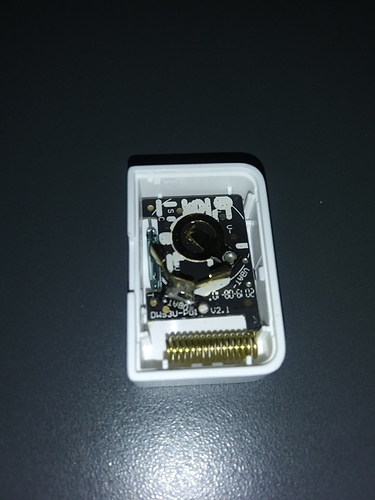

Welcome to the forums! I wonder if the switch in the larger part of the sensor got knocked sideways or something. Can you post a picture of the inside of the larger part, under where the battery would go?
All seems well inside, AFAIK.
I thought the same, but nothing visually wrong?
