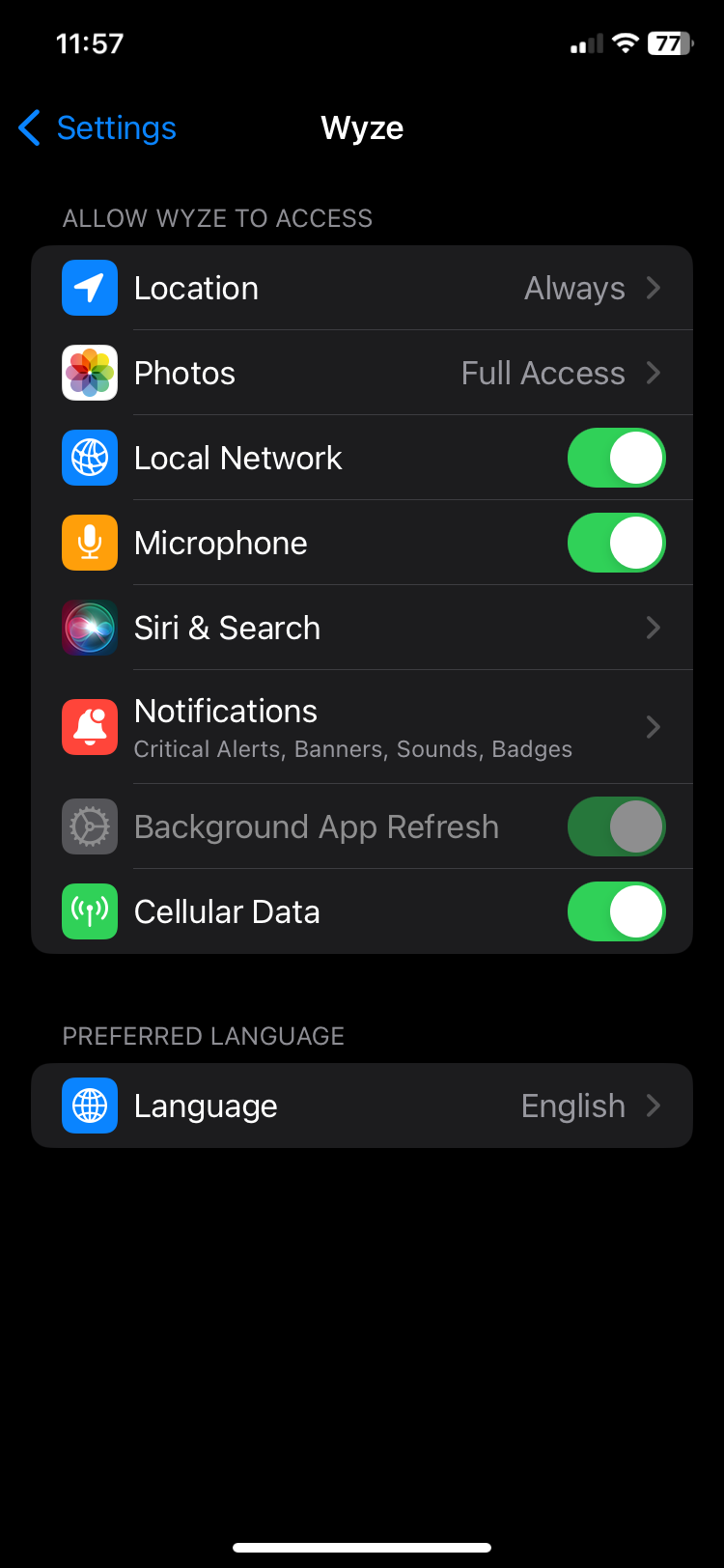

Making this change in Settings and granting the wyze app local network access does not remedy the issue.
Correction: It does work but required a full reboot of the iphone and not just force closing the app.

They added a new security feature to block access to the local network until you grant that permission. Nothing Wyze can do about that. If you have an issue with it, complain to Apple.

I’m not sure why you addressed me directly, but I think Forum regulars are making this suggestion because it seems to be the working solution for a lot of iOS 18 users (of which I am not one). It’s apparently such a widespread problem that even Wyze added a note on the Help Center home page several days ago:
:information_source: 9/18/2024: Error code 22005 on iOS 18
If you’re getting Error Code 22005 when trying to view a camera’s Live stream, go to your device Settings > Wyze App and toggle on Local Network access…
Yes, the cameras had access to the local network and still do, but the change introduced by iOS apparently affects the Wyze app access to the LAN unless a user changes the setting as described.
