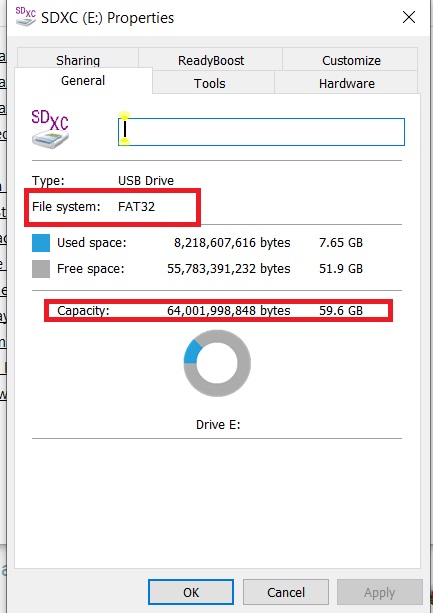

I have this 64GB card formatted in FAT32 and is has the correct capacity of 59.6 GB. I used the Ridgecrop GUI formatter to format the card.

One more note. If you format a 64GB card or larger to FAT32 on a Windows PC the Max you will get is 32 GB. You need to use a different format tool. I have used this tool for years. Just click on the picture to download and save the program. I am sure there are others but this has worked for me numerous times because my old dash cam would take large cards but only in FAT32, new dash cam will use ExFAT. I formatted the 64GB card long before WYZE made ExFAT usable and I had good luck with it in my V3.
