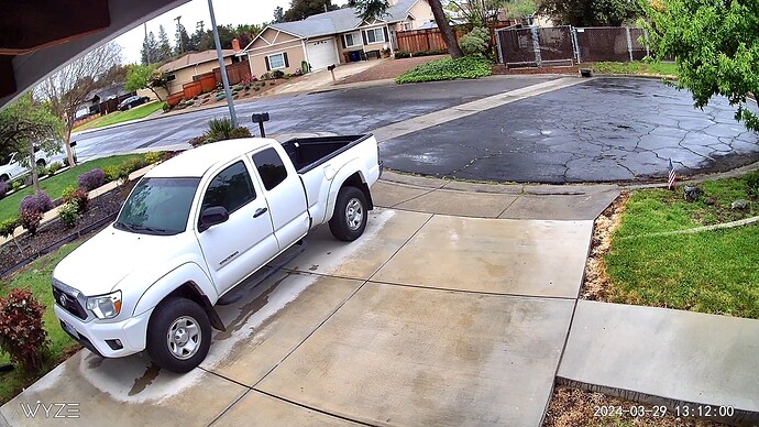

I don’t have my V4 outdoors yet because of the current wind and rain and I don’t want to melt. I do have a V3 PRO and I leave the night vision off because I have enough ambient light and it provides a great color picture and recordings.
Got a few minutes break in the rain and moved some cams around. I got the V4 up so I’ll see how it works tonight with night vision off like I did with the V3 Pro.
