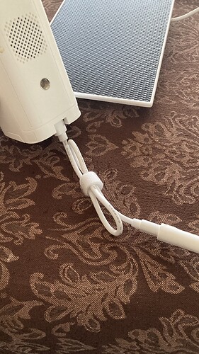

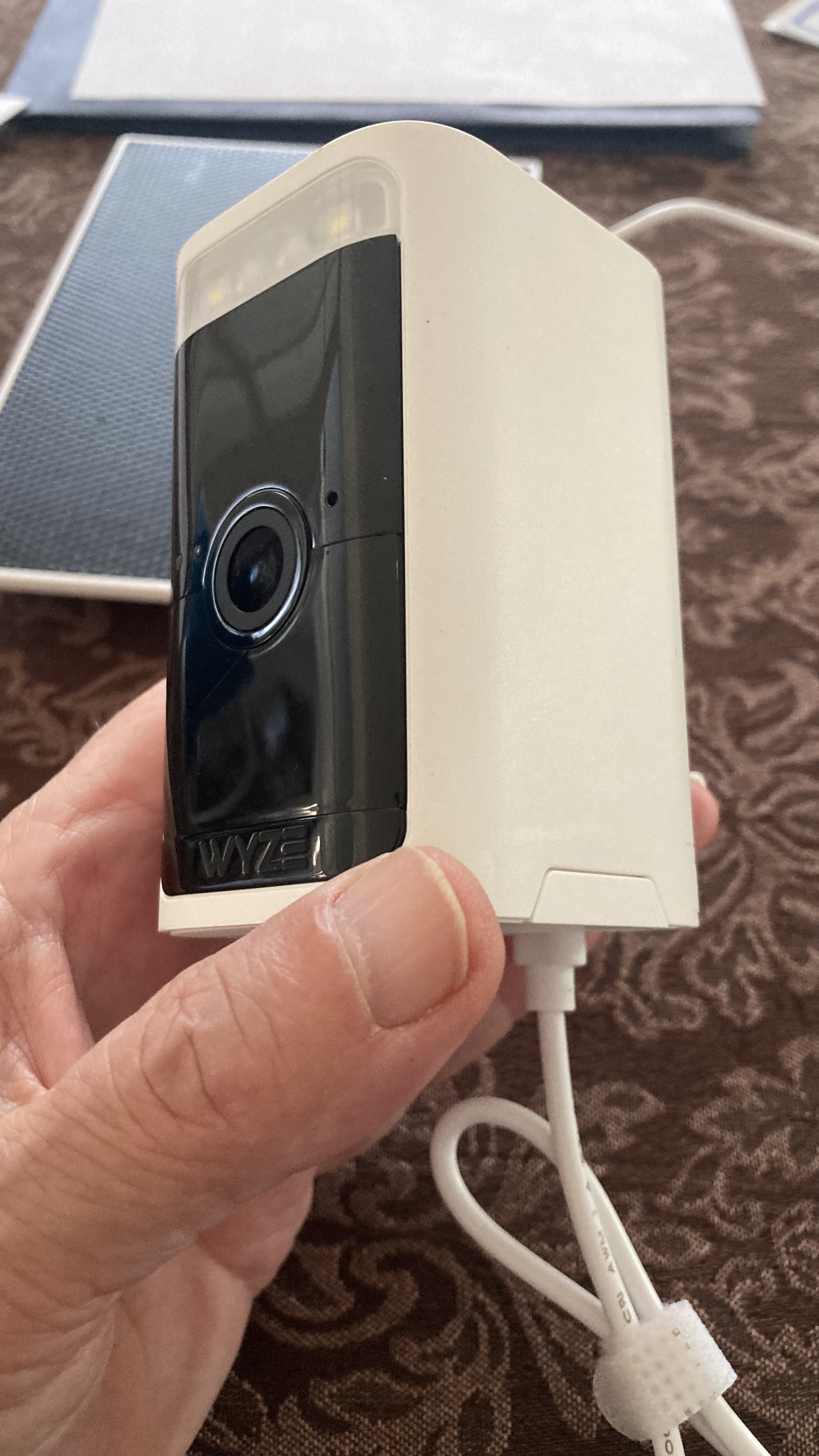

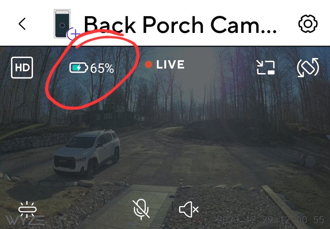

I’ve had the cam for almost 2 weeks now, check the app daily sometimes multiple times. Again, it is NOT going up in %, it is going down. The status light does not come on. I have the cam mounted so will have to pull it down to try and plug in to ac. The panel is in direct sunlight (vegas sun) prior to mounting, the camera charged via plugging into ac, and also the battery LED lit up when directly plugged in. the only variable is the panel imo. all my other cams stay at 100% very rarely go down to 99.
Turned the camera off for the day and checked it here and there. It’s up 10% battery so far. Still no charge indicator so it’s likely working for most just can’t keep up with the power demands depending on use.

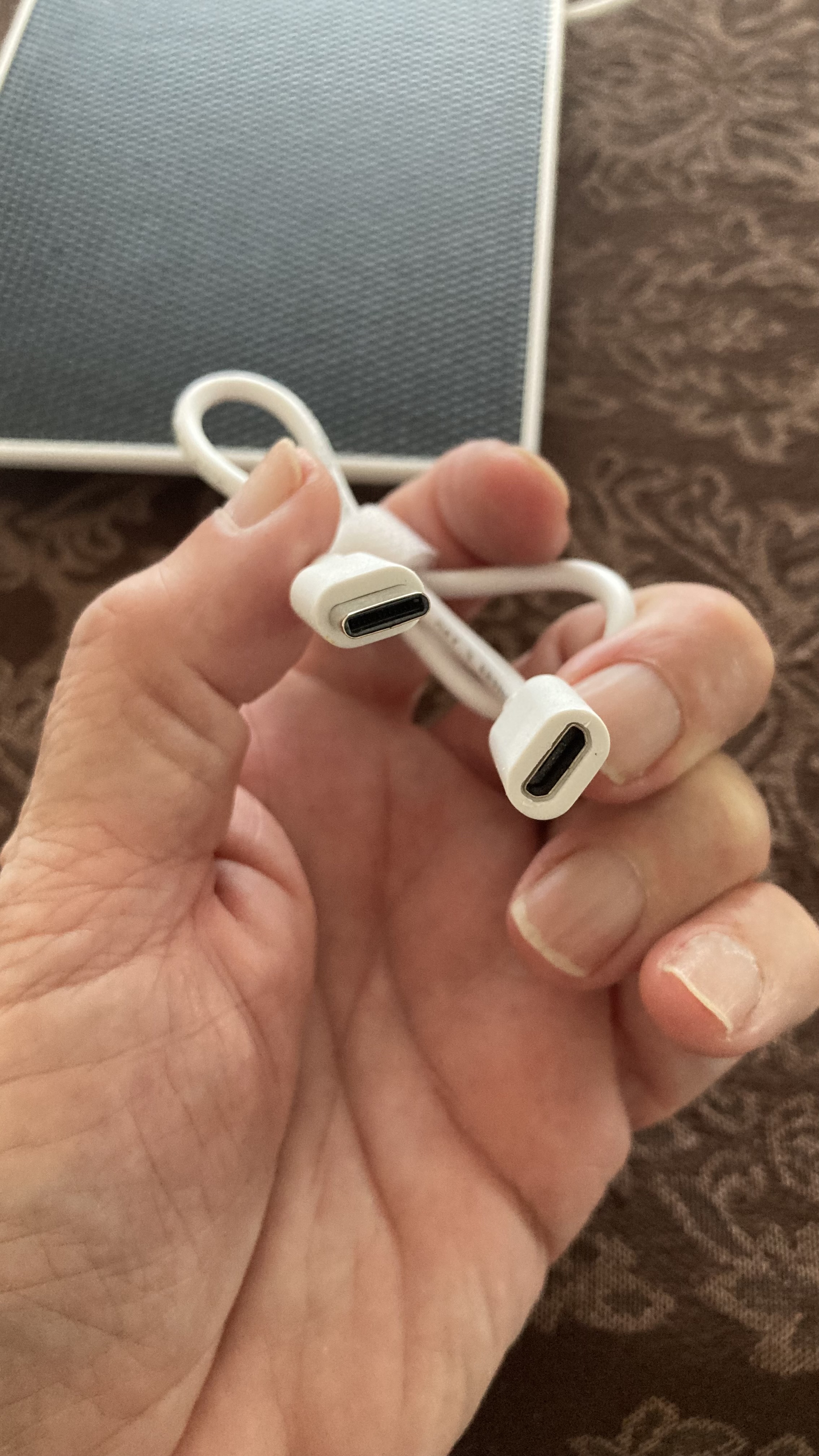

I assume everyone is using the USB-C adapter with the solar panel to plug into the Battery Cam Pro, unlike their other cameras that use micro USB. And if you already had a Wyze solar panel, it didn’t come with the USB-C adapter prior to the Battery Cam Pro release. Also, the charge indicator light on the camera only flashes a few times while charging and does not continually flash.
Yep, my panel came with both adapters. and my status LED does not flash at all. only the initial setup flashing, and the red “connected” status. I may try the turning off cam for a bit and see what happens. I really starting to think it’s a bad physical port.

Same issue here. I bought both items together and was excited about the solar panel. There was a USB-C adapter in the box (which doesn’t allow the cam to sit upright on a flat surface) but the panel is not charging the camera. I live in SoCal where there is no shortage of sun and it’s just not charging.
