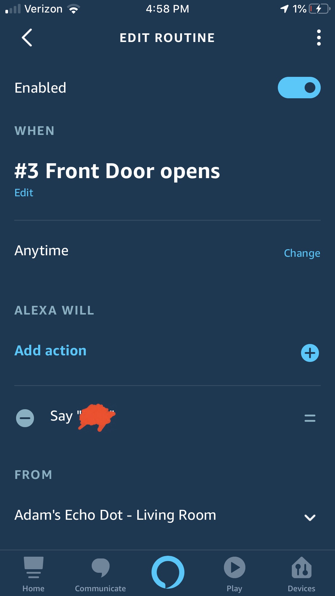

You can do it as an “Announcement” instead of “Alexa says,” and it will play on all devices, but the only way I know of to do a beep is to write a curse word, (Funny, but it works.) The only problem is that if you do that as an announcement, Alexa does its own chime sound first, so you’ll get sort of a double chime.
You can see my “F-word” method working below, but that was with “Alexa says” as opposed to an announcement. With an announcement, there would be an additional sound before the beep.
