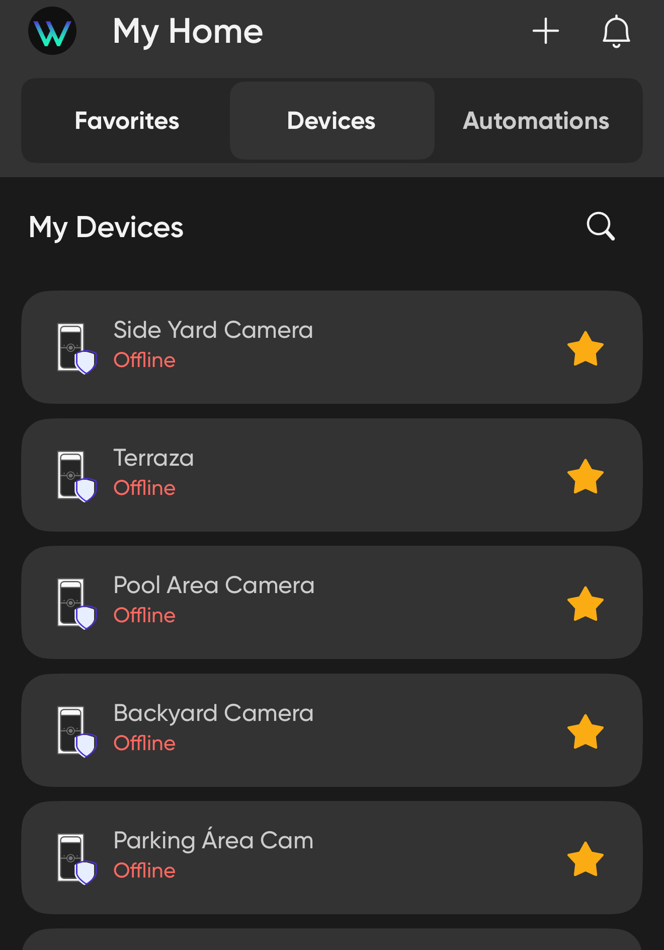

Did update and cameras went offline the nect day. Reset everything and now another 2 days they are offline again. Very frustrating. Not always available to reset…anyone else having this issue. No issues with internet…

I’ve been using six Wyze Battery Cam Pan Pros for the past six months without any problems. They’ve always had a strong connection on my AT&T Fiber 2Gb network. But starting about a week ago, they all began going offline repeatedly. Sometimes they reconnect after a long time, but most of the time they stay offline. This only started after I updated the firmware on each camera, so I’m wondering if the update got interrupted and caused these issues.
