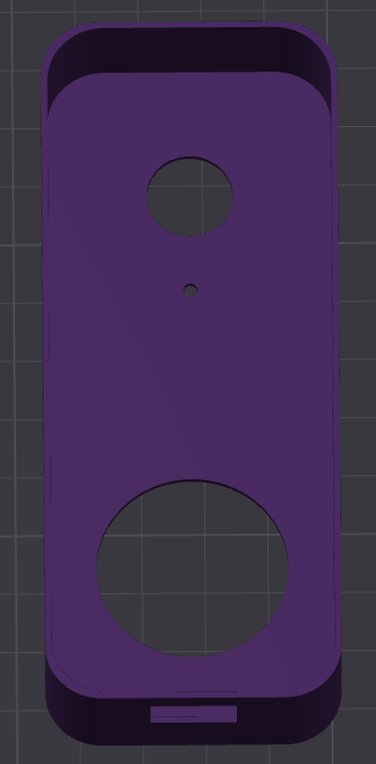

Created a 3DModel so you can print a skin for the Video Doorbell v2 in any color you would like.

How do you attach this to the device? Is it just a friction fit? I read “Snug fit” in the Printables description.

Yea, Friction Fit is a good way of putting it. It will work with a Wedge as it does not go to the bottom of the Doorbell. I opted not to go to the bottom because the doorbell is not perfectly square and was harder to remove. So you should be ok with it and a wedge.
If you need changes, I can make those or provide my Freecad File for use.
