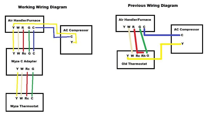

Thanks to comments here and elsewhere on the forum I was able to figure it out. What wasn’t clearly stated or shown in any diagrams was how it should look with the C adapter in place. Since the original Y Wire from my old thermostat was going directly to the AC compressor and not to the air handler, I had to split that connection and connect the wire that goes to the AC compressor directly to the air handler as @speadie mentioned. Then put the Y wire coming from the thermostat to the Y port of the C adapter. I’ve attached a diagram showing the new wiring configuration. I reset the thermostat by pushing the button for 5 seconds and went through all the setup steps again. It’s working perfectly now.

@RabidMitch and @speadie, thank you for your help. I have resolved my issue. My Y wire coming from the thermostat was split before the control board to a wire running to the ac condenser. I rewired the system so that the Y wire had a continuous connection to the control board. From the control board, I now have two Y wires, one from the C adapter and one going to the condenser. Basically the split to the condenser needed to happen at the control board and not before it.
