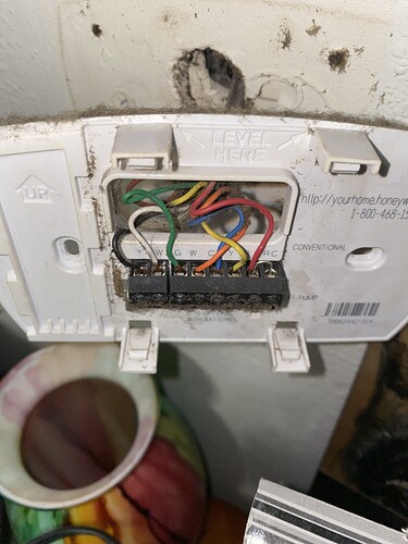

The fan blows and that’s about it. So cold air when air is on and no warm air when heat is on. I do get the smell of the heat when I turn it on. I’m in Louisiana in a loft apartment so I don’t use the heat much if ever. Here is the pics of the wires

I think you have a heat pump. use the labels on the lower part of your old thermostat to determine the wire labeling.
Where does the orange wire (labeled W1 on your current wiring) go? I need to see it connect to the control board.
I believe your wires should be labeled from left to right:
Black wire> unused
White wire: Aux or E
Green wire: G
Orange wire: O/B
Blue wire: C
Yellow wire : Y
Red wire R

Below are pictures of before and after.
