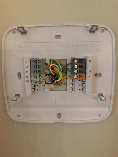

Help! I set up my new thermostat today! It’ll turn on inside (fan) but my outside air conditioning units fan isn’t spinning. When I “test” the thermostat it doesn’t blow warm air out, the outside unit obviously isn’t working so it’s not putting out any air, it also doesn’t blow out cold air on the last testing step. It’s always the same temperature, mild “air” feel. Here’s what my wiring looks like!
If anyone could help me, that would be awesome! Thank you!

Since it looks like you have a Heat Pump, did you indicate that during setup?
If you did, there is an option in the setting to switch the O/B for heat. You may need to do that.
