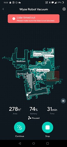

FYI, seems like resetting the map resolved the issues I was seeing w/ the ‘turned base and maps’. I’ve run several scheduled cleanings since and, so far, no issues after deleting the map, quick mapping and then creating new schedules. I also haven’t seen the return of the lidar timing out for a bit but too early to tell considering this a 2 event random issue.
sigh
Same issue again this morning - lidar timed out and map turned.
back to waiting on support for next steps.
Maybe it’s a hardware issue…
Agreed, that’s what I’m expecting at this point considering the 3rd recurrence after resetting the map twice.
I kinda hate to suggest it, but maybe resetting the map and remapping the slow way would do something. Mine has been working perfectly after remapping this last time. I too hade the angled maps forming as an overlay. Bugt I have never had the lidar issue. That’s what makes me think it could be the hardware…
