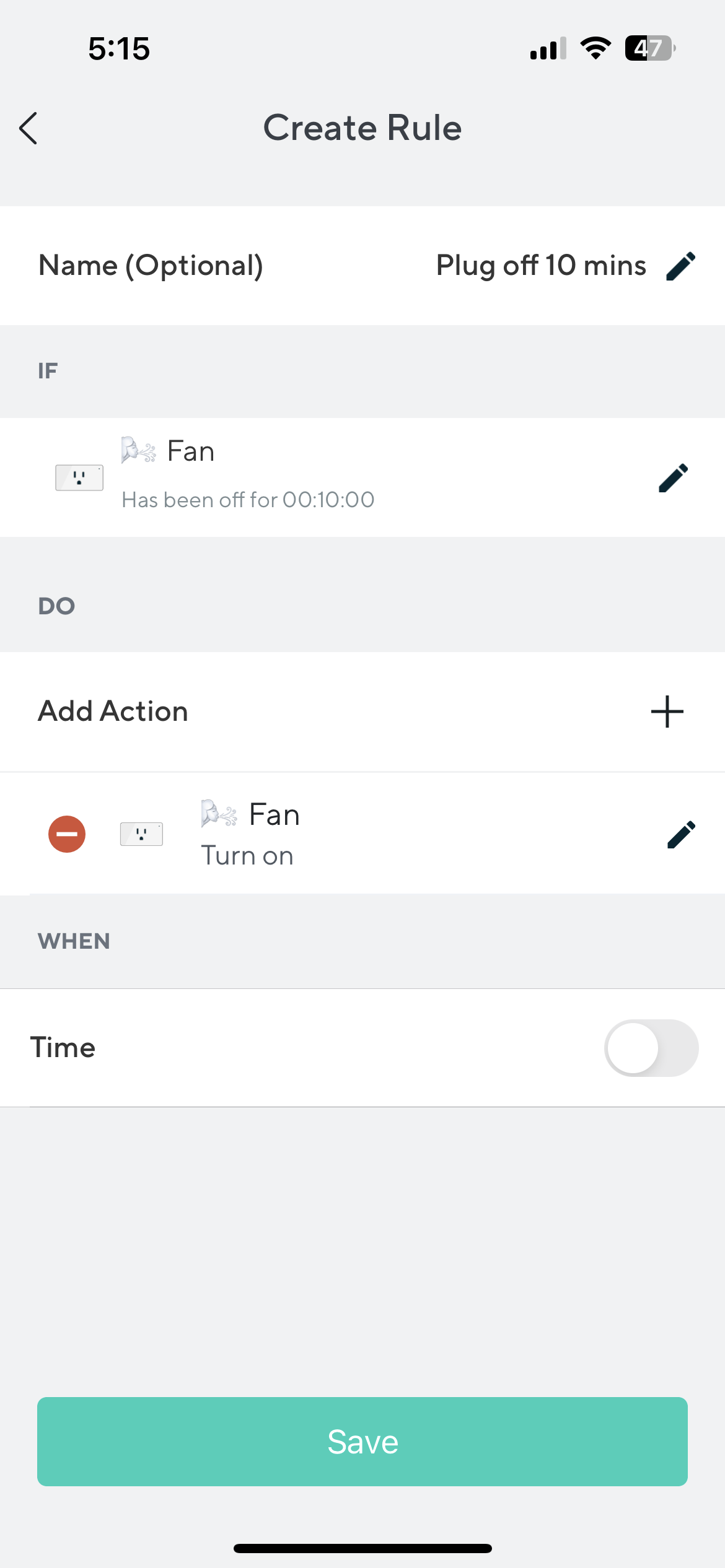

I am trying to get a wyze plug to come on for 1:30 every 10 minutes. Is there a way to do that? I cant even set the rules down that low it seems. The smallest increment I can do is 10 minutes on.
Welcome to the user-to-user forum @M1stwr4ith!
Yes, you can do that using a Device Trigger Rule. Using a hypothetical Plug named ‘Fan’:
Rule 1: If Plug off for 10 mins, then Turn on Plug (or 8:30)
Rule 2: If Plug on for 1:30, then Turn off Plug
Automatically loops back to Rule 1 for the repeat
