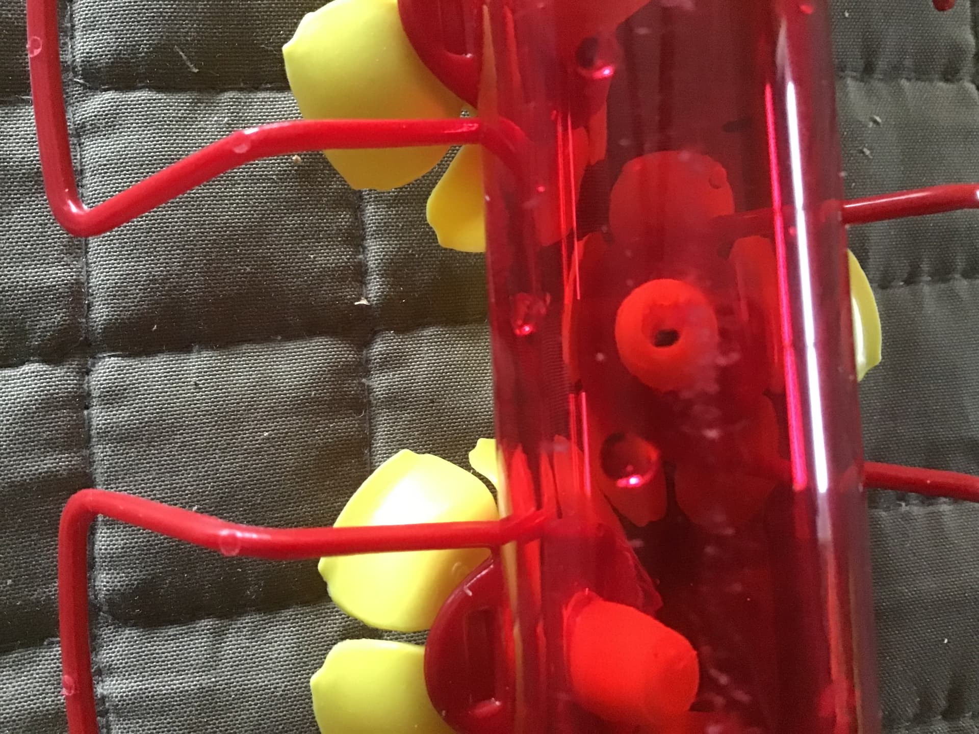

Saw this hummingbird feeder online a while ago and was going to buy it but the reviews pointed out some issues with the design.
  1. To fill the feeder, the tube is stood on end, a cap is removed and the tube is filled. But there are holes in the tube where the flowers are so most of the nectar leaks out before you can put the cap on and return the feeder to the horizontal position.
  2. The feeder is suspended by plastic hooks. The feeder sways in the wind, causing the nectar to slosh in the tube and come out of the flowers.
  3. The wall thickness of the plastic tube is so thin it can be squeezed.

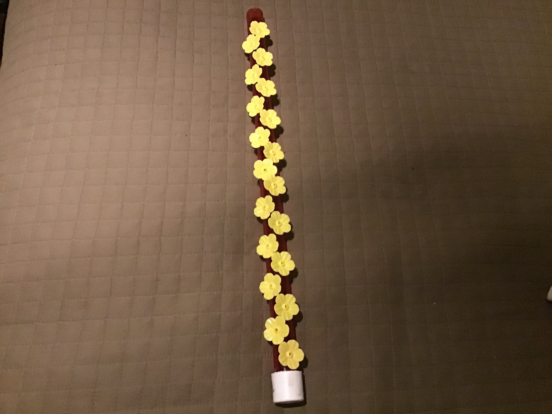

Bought these to start

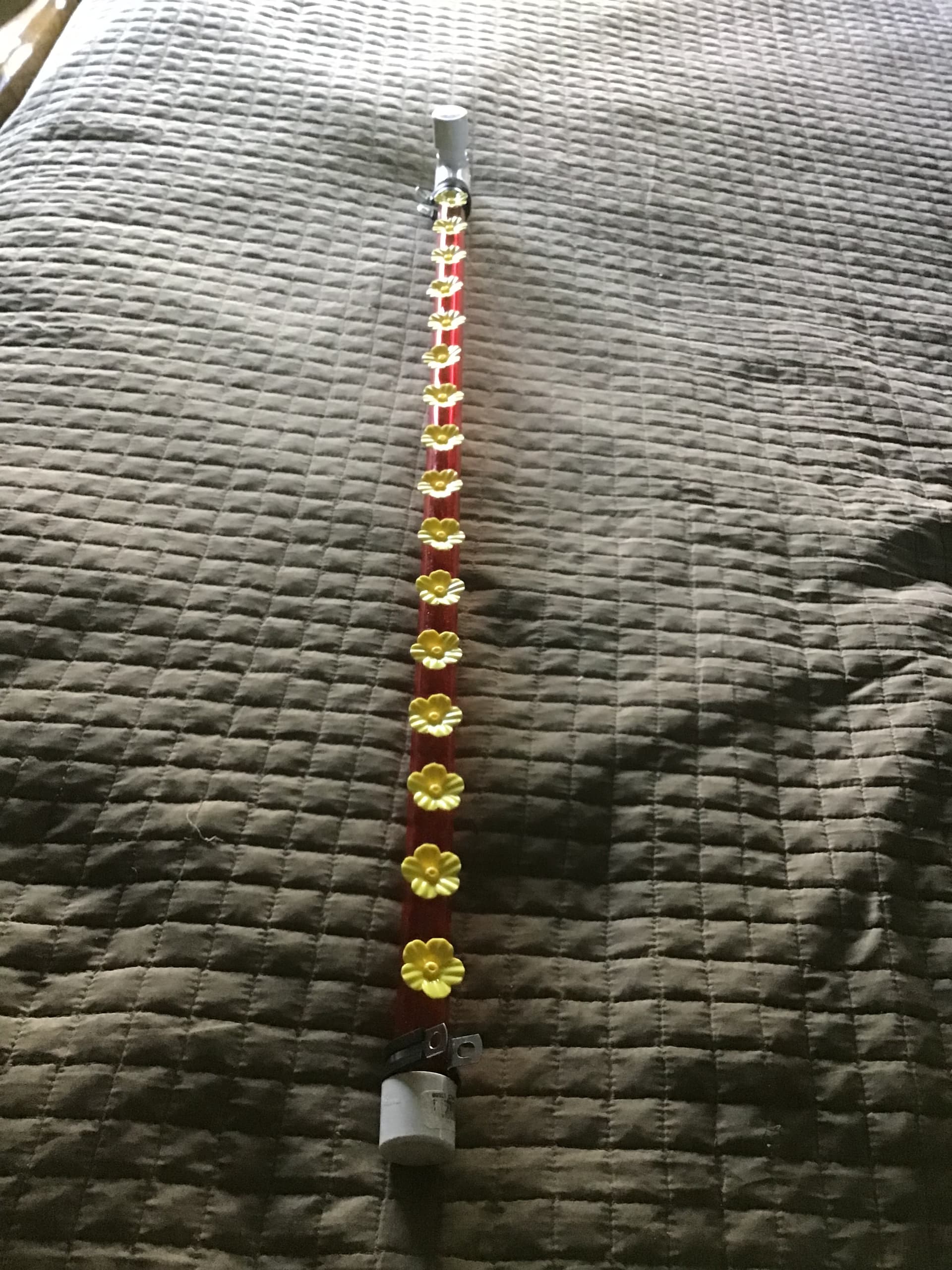

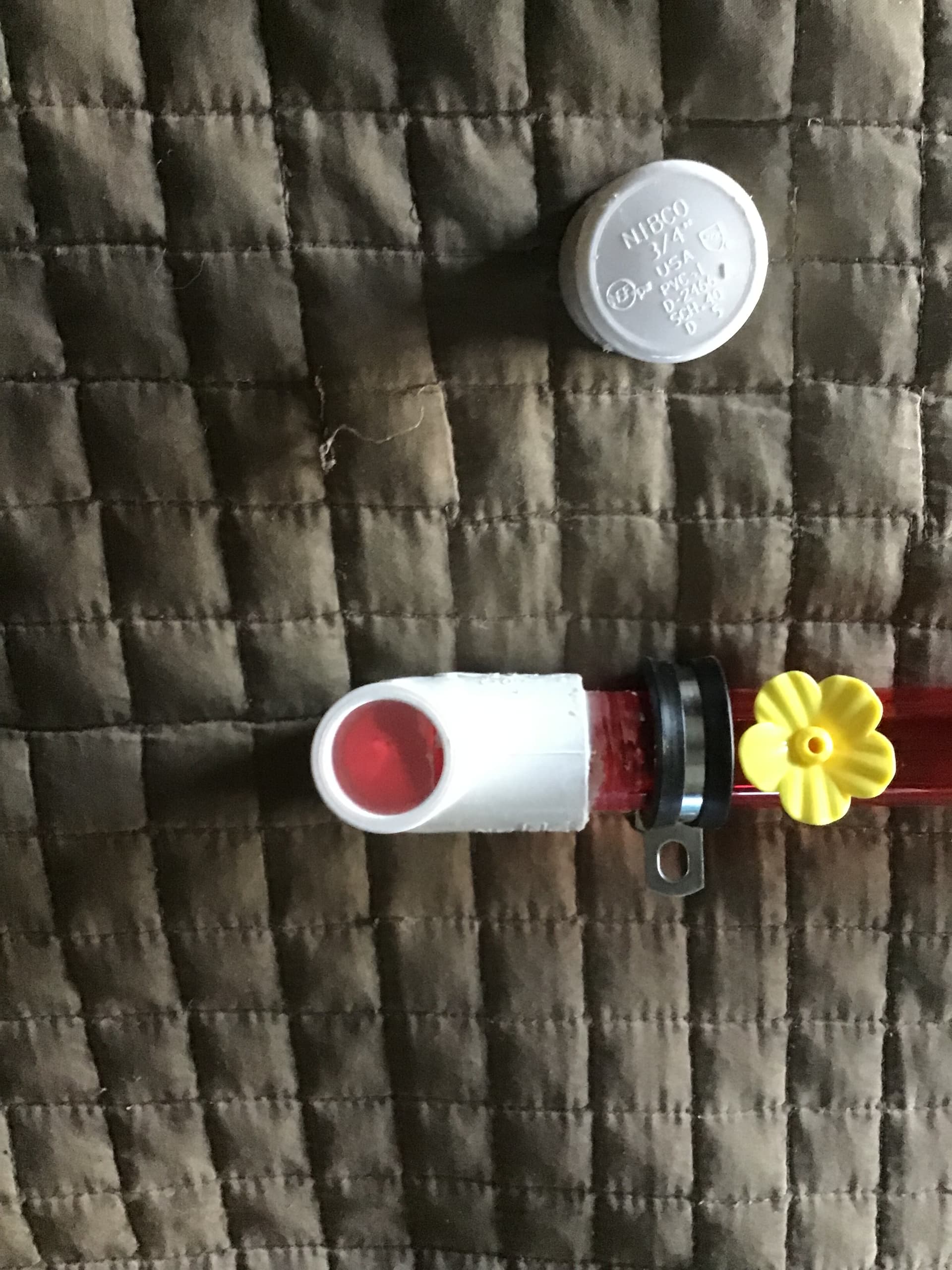

To address the filling issue, I glued a cap on one end, and a 90 degree street elbow with a removable cap on the other end. To fill it, I just remove the cap and use a funnel to fill it
To address the swaying issue, I used a rubber covered clamp at each end which will be attached to a shepherd’s hook.

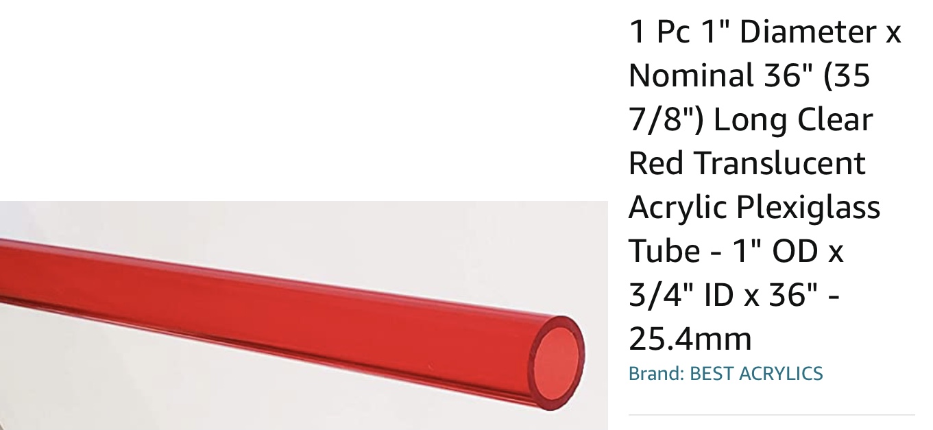

Finally, the tube I bought has a 1/8ā€ wall thickness. Can’t do a ā€˜Mr. Whipple’ with this.

I added a few more flowers and plan to add another row at a 45 degree angle so they can feed from both sides
Interesting. Now maybe add a long bar to the side and above so they can sit and drink at the same time. I like to use the ones with a perch and they like sitting on them.
Already changed the design. I like your idea and should be able to add that.
Cut the tube down and staggered the flowers.

Version 3
Getting crowded
Waiting on clamps to mount it.
