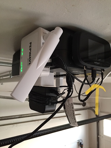

Ravpower makes a 6700ma battery charger that has through put (pass through) charging, and surge protecting.
$18?ish
You have to use a 2a adapter bc the wyze cam 1a won’t keep up, but works great. Get a 5-6 hours of recording if the power goes down.
Router and mobile hotspot are on a Cyberpower UPS. Someone trips the power gonna still record.
