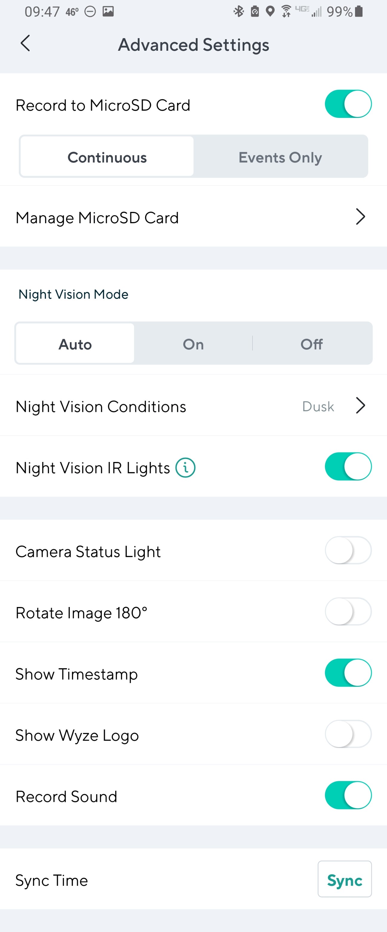

The V3 has a setting for “dusk” vs “dark” for switching in and out of night mode, but I see the V3 Pro does not.
v3 Pro has the same. You need to set Night Vision Mode to Auto in order to enable the Night Vision Conditions setting. Setting NVC to Dusk switches Night Vision (B&W IR view) on earlier. OP should set NVC to Dark to maintain color.
I checked that yesterday, but the camera I did the test on is normally set to Night Visin Mode = Off. I did turn it on, but I suspect I missed and hit “On” instead of “Auto”. Confirmed what you said…
