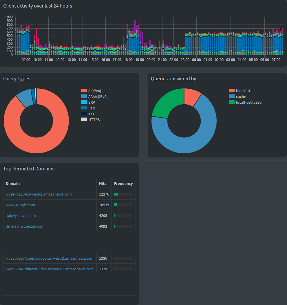

Wyze Cam v3 exceeds 60,000 DNS lookups per day

My Wyze Cam v2 is doing something similar, but going to different sites.
*.kinesisvideo.us-west-2.amazonaws.com
aws-iot.wyzecam.com
*.iot.us-west-2.amazonaws.com
You can clearly see when I reboot the device and when it starts up again. I have tried reverting to older firmware, but that did not help

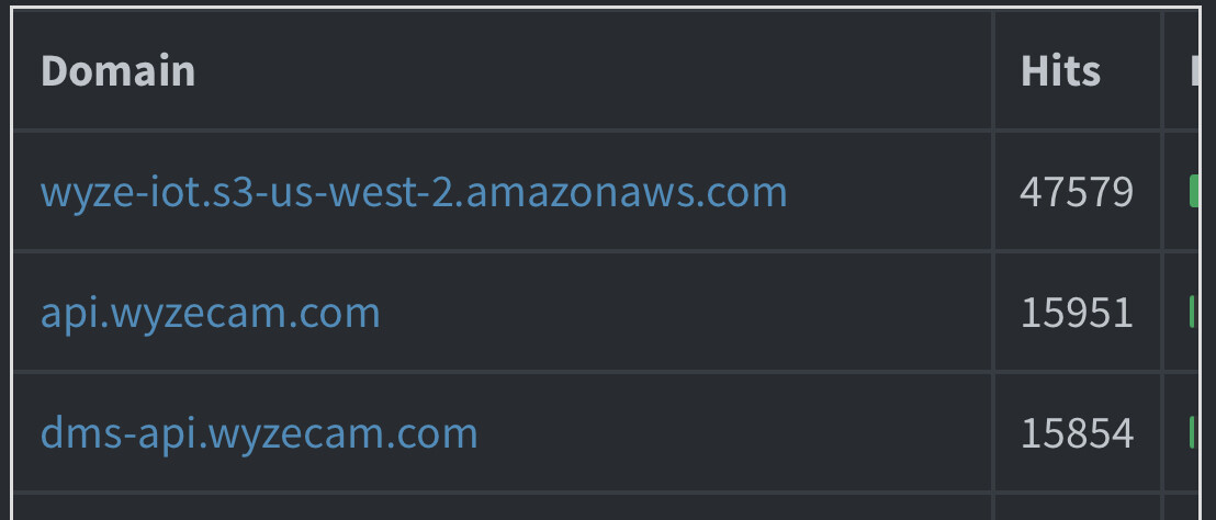

This is what I’m seeing and I don’t have any V2s connected. Have a few V3s, a Pan and outdoor cams.
So what is the issue? Performance? Quility?
That and the typical sloppy Wyze QA.
What??
Performance issue because of excess, needless, lookups. Sloppy QA because it’s apparently a bug (or test code) in the firmware that was released to the public.
