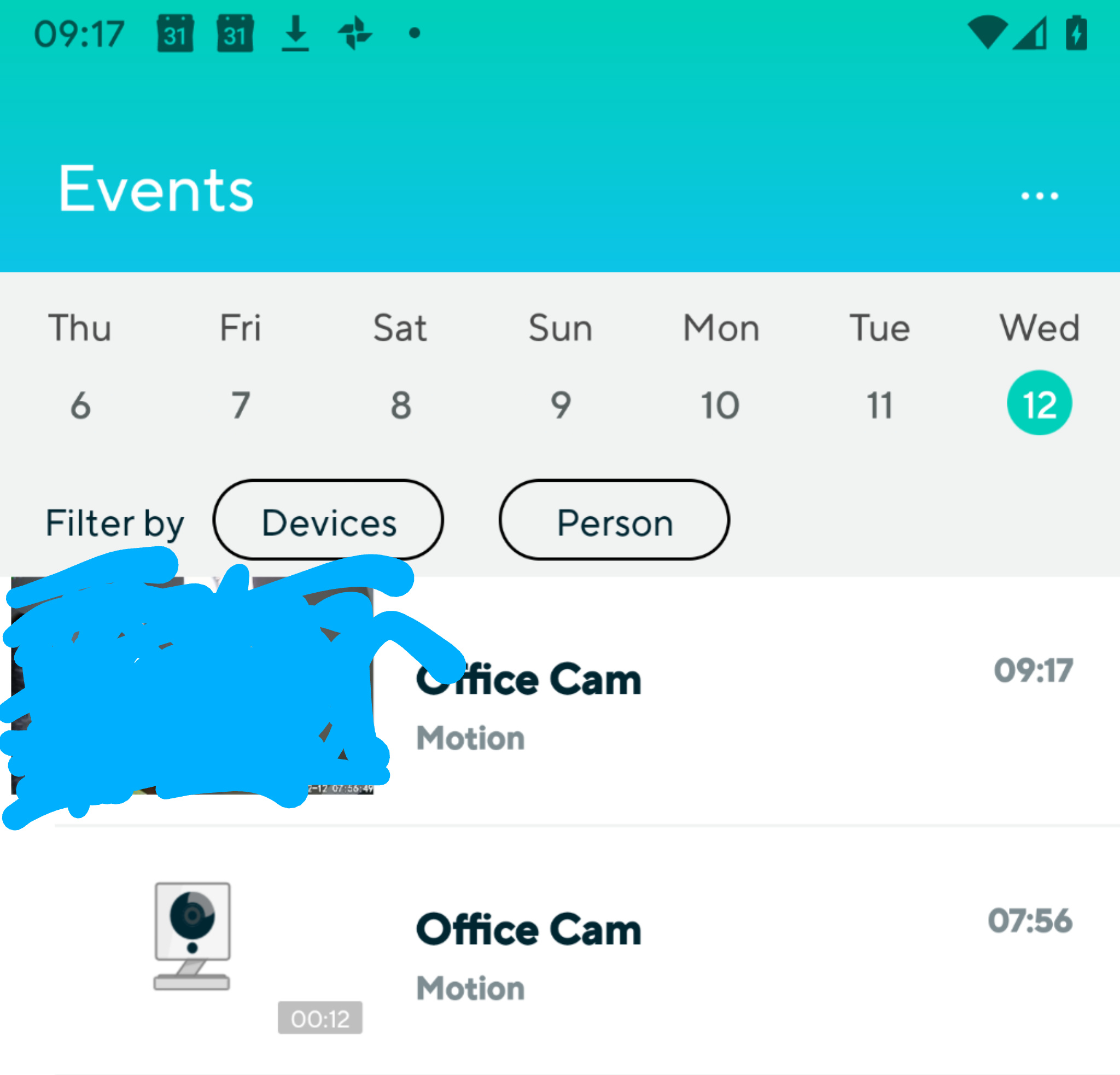

I have the same problem. I correspond with support. Recommended to flash the old firmware 4.10.3.108
Motion detection and alerts started working!
You’re right. Motion detection is back in that firmware. However there is still no recordings of the event.
