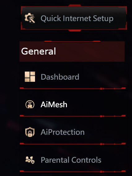

Go to the AiMesh tab of the Asus router’s web admin. Verify that no camera is trying to connect to the wrong node.
This tab also has “System Settings->System Reboot”. This is more convenient than rebooting each node.
