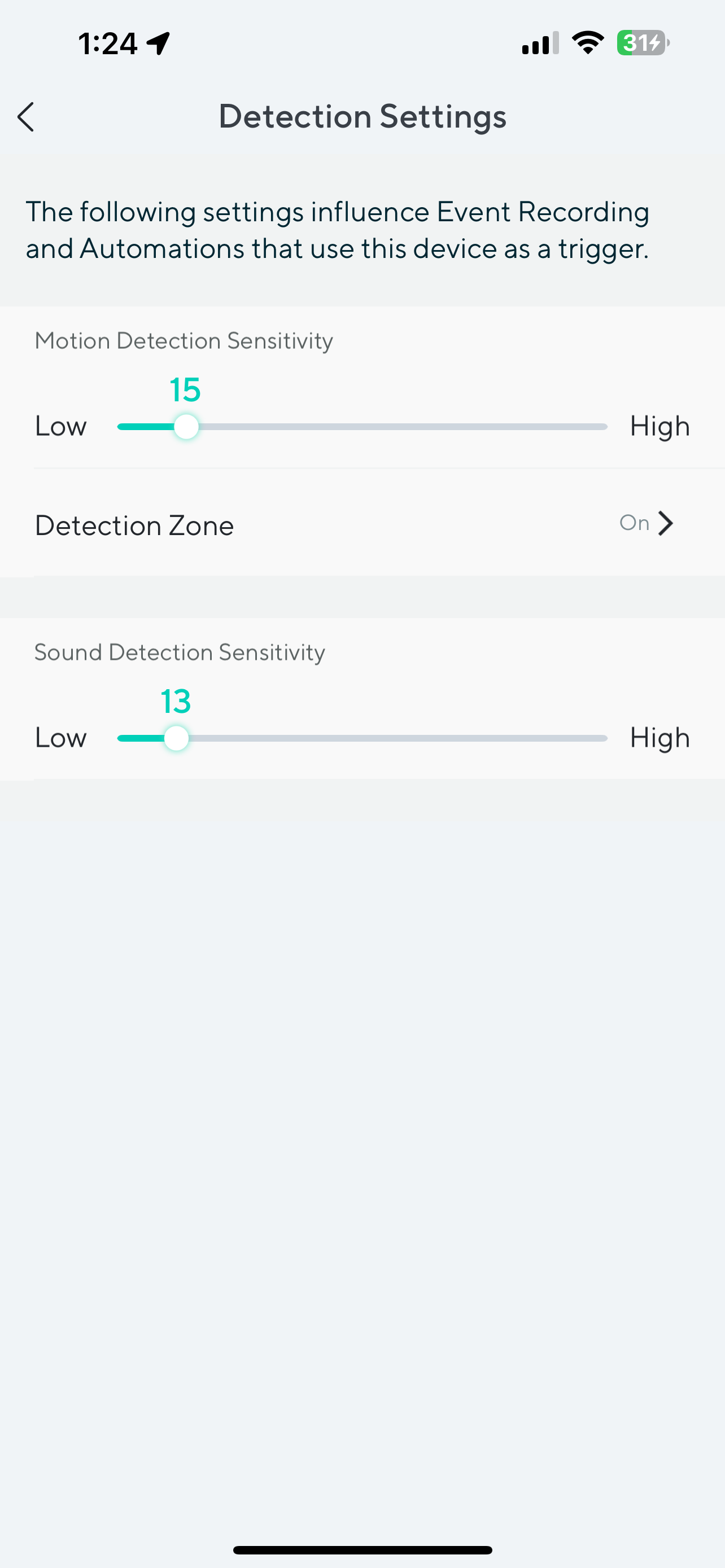

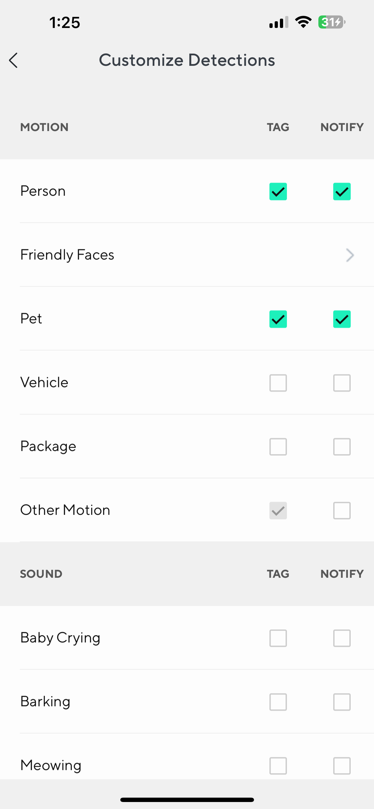

I have Cam Unlimited service. These are screenshots of my current detection settings but I have been fiddling with them. Previously motion was in the middle and sound was very low. While trying to fix the problem I’ve set them both high and reset the settings to default.
Just to be clear, the camera records motion but isn’t tagging it nor sending notifications for pets? Do you get person notifications? I also see you have a detection zone enabled…try disabling it.
One question I have is why is Other Motion Checked but Greyed Out in Jan9cat’s screenshot?

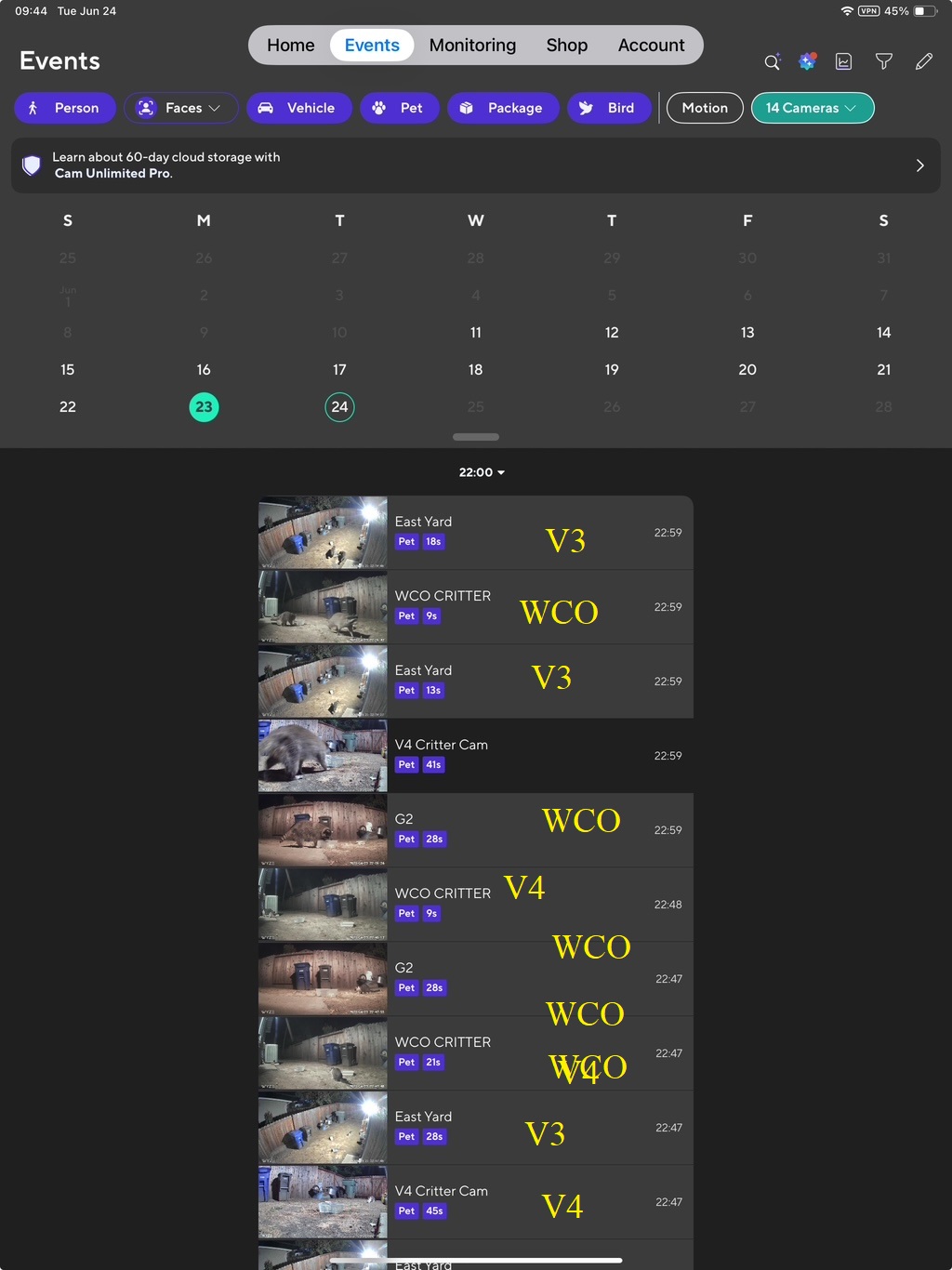

I thought I saw what I perceived to be a reduced amount of “Pet” Activity for a few days. This morning I saw my pack of three coyote’s trigger one of my Floodlight Pro’s, and one of those coyotes triggered three BCPros, One WCOv1 and a V4.

So I’ve been following this post and trying to find the solution myself as I was running into it but upon checking it today I’m seeing animals now. Can anyone else verify this? I noticed it a few days ago and came here to see if it was widespread and at that time I didn’t see much. But it has since grown and I’ve been trying to troubleshoot mine.
This is on a V4 but very vague settings with record everything turned on and I have unlimited.
You can see this is only from about an hour ago Eastern

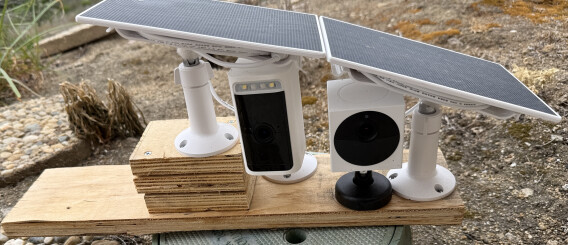

I originally set up this ‘rig’ to place just outside my sliding glass door to record my coyote pack that wonders through my back yard on the regular, hoping to prove, or disprove that the WCOv2 was actually recording without any cooldown. (I think that is working properly now, but still need to test to satisfy that is indeed the case) Placing the BCPro next to the WCOv2 would hopefully show the two cameras were or were not recording the same thing.
Anyways… back to the subject at hand. I moved the rig down to the bottom of my hill, and placed it on the cement block fence facing the field, the goal being to record anything that occurs at night in that field. (I’d recently watched a documentary that said there were Mountain Lions nearby my location)
So, down the hill I went to place the camera’s…
The WCOv2 on the left, and the BCPro on the right facing the field.
Days went by and I got nothing but grass blowing in the wind.
Then one day I saw a coyote on the WCOv2 (and not on the BCPro). I didn’t think anything unusual at that point. (I’d not seen this thread yet)

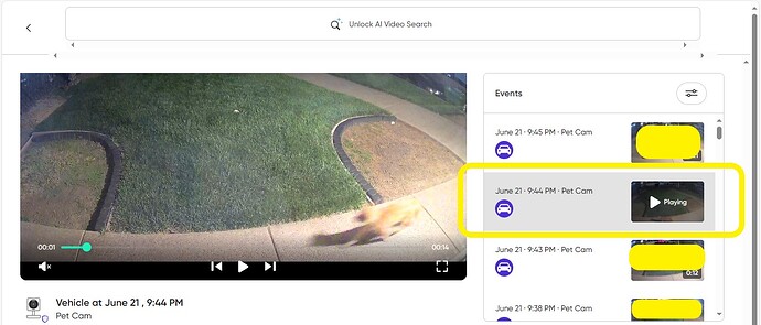

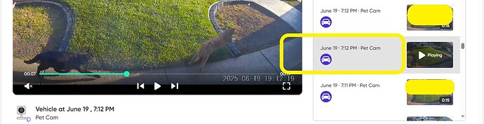

When is Wyze going to acknowledge there is a Pet detection problem?

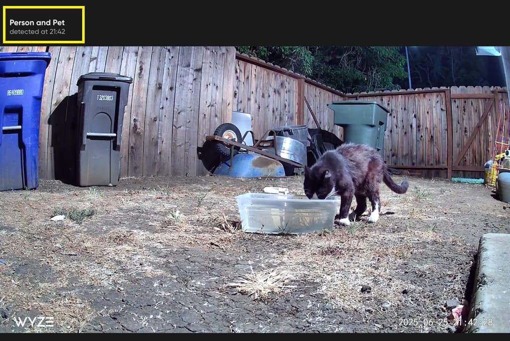

Here are two examples with my OG Cam Plus.
I have not had a Pet detection in the past 4 days.
In the past I used to get at least 2 to 3 Pet detections a day.
