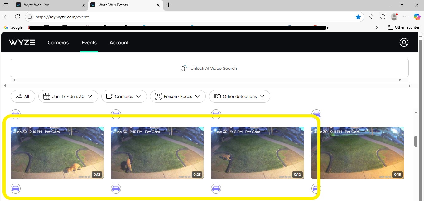

I have at least 85 PET detection videos events record between 7:00 PM yesterday and 6:00 AM this morning. Your camera is obsessed with the vehicles in the field of view. Do you need to see the vehicles?

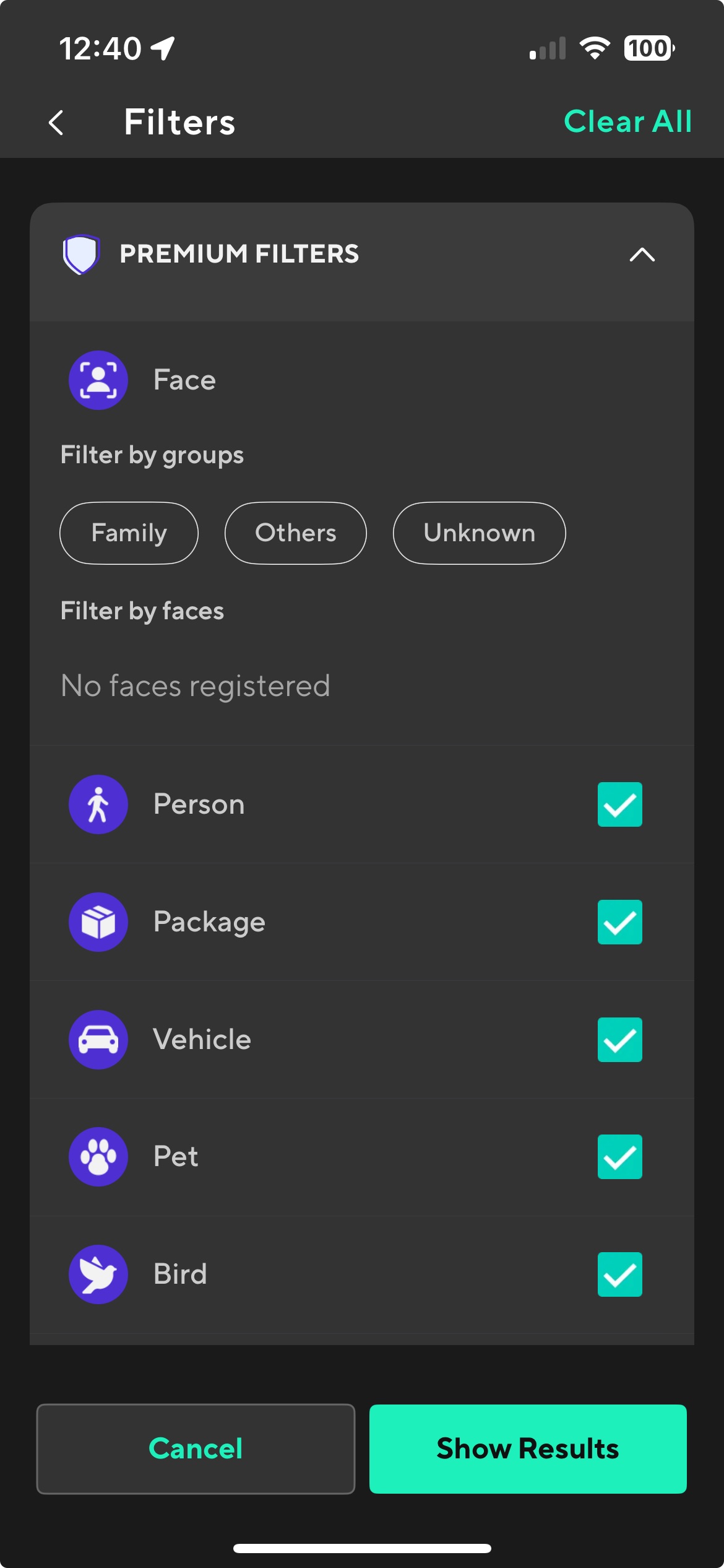

If not block them out with a detection zone. Do you have Pet selected in your event filters?

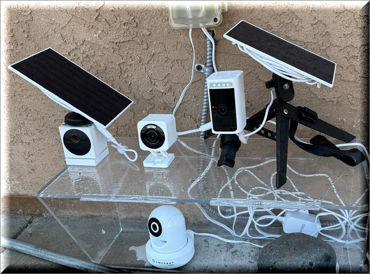

I have another "test platform’ setup in my back yard, above it is a Floodlight Pro to ‘watch’ what’s going on down below:
I recently had a Coyote willingly participate in a test of a WCOv1, V4 & Battery Cam Pro as pictured.
He jumped up from the hill, and paraded in front of all three cameras as shown in the Flood Light Pro footage: (I’ve trimmed the video to show his path in front of the three cameras):
Two of the three camera’s recorded the Coyote, and one did not.
Surprisingly, it was the V4 that did not record the event, while the two Battery/Solar powered Camera’s did record the event:

Based on my previous example where a BCPro failed to upload a video, and in this case where the V4 failed to upload a video, when the BCPro and WCOv2 did record the event, would it be safe to say there is a random issue going on that is causing some Camera’s not to detect and upload an event?
My issues, as others have seen, appear to occur at night.
I’ll keep monitoring this issue, and post examples as I see them occur.

Here is another example. This cat was running around frantically trying to catch bugs.
In the good old days, any cat in my front yard would have created a Pet event.
Not pet detection but…
Did Wyze Tag the video as Vehicle?
Nah… No CamPlus.

For my WCOv2 / BCPro Rig that I have ‘watching’ the field behind my house, I have them next to each other with overlapping coverage.
I did this to prove or disprove proper function of both camera’s (initially to test the WCOv2’s cooldown period of ‘No cooldown’ was working properly).
Discovering the deer were frequenting the field behind my house was a bonus.
Discovering the BCPro was ignoring that deer (no upload to the cloud w\CamPlus, as well as no entry in events on the BCPro) was not an issue I was expecting to experience.
