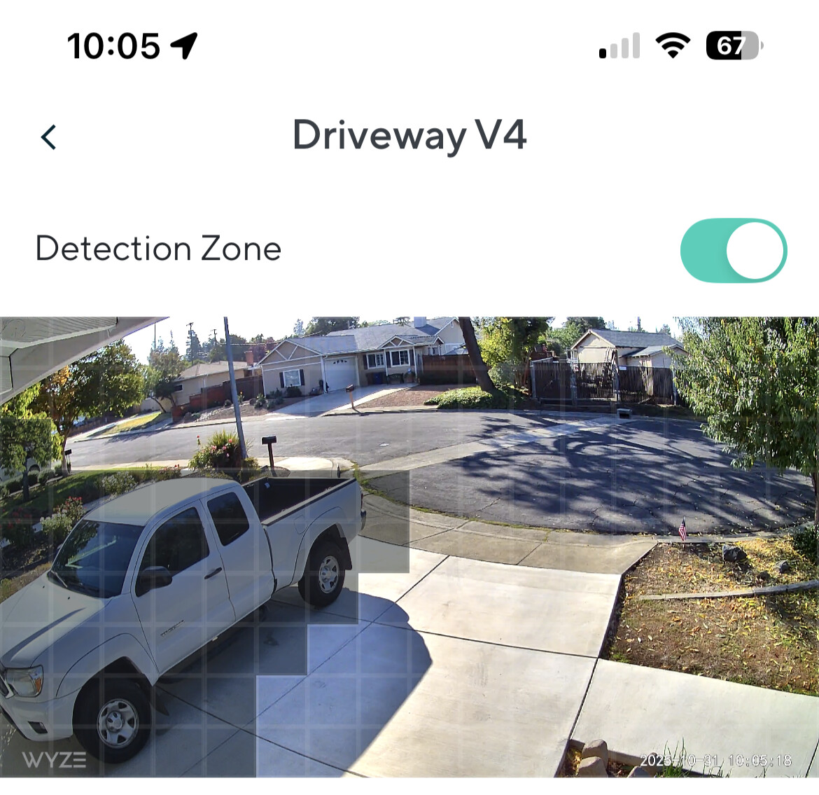

The workaround that most use is to just exclude the area that cars normally park from the detection zone. It would still catch someone walking up to the car etc so it doesn’t really reduce the functionality, and prevents it from identifying the parked car. Which means that obviously the uploaded image must have that area blocked out, so again, you’d think it would be easy for them to upload the “green box” area where the motion actually happened.

This works for me, truck is blocked out, no vehicle alert. If I walk up to or past the truck I get person alert. :grin:
