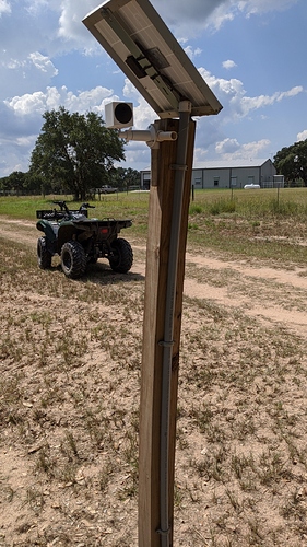

I just did a modification to the V2 using both a rubber stubby antenna and a larger WiFi aluminum yagi antenna. The camera is in a 3rd party outdoor housing. I compared the range using the small exterior antenna to my new Wyze Outdoor Cam and got much better range and signal all the way to my entrance gate here in the country. I imagine that is at least 60 yards. The V2 worked using a WiFi extender with two small rabbit ears antennas on top of it perched in my window, thus eliminating the need to run an Ethernet cable around my room from a closet where the router is. (My house is not wired for ethernet.) So with better range using the V2 and a wireless WiFi extender in the window, I have a better outdoor camera. With permanent power provided to the V2 using a solar panel and a plastic ammo box for the electronic: a solar controller and a 12V to 5V converter, my V2 is virtually autonomous, self-sustaining. I’ve experimented using the yagi antenna and gotten over 150 yards, so far. But I’m wondering how much further I could get with another yagi connected to a modified WiFi extender. The yagi does have to be firmly held in place directly aimed back toward the extender at the house. I should note that in comparing the Outdoor Cam I did run an Ethernet cable alongside the wall to my window to test the Outdoor Cam base with the Outdoor Camera. The V2 was better.

Standard WiFi yagi. Found one on Amazon for about $13. You can see it in my photos.

I am getting over 970’ using a yagi antenna. It’s not amplified. It is attached to the camera and pointed back toward the router.
