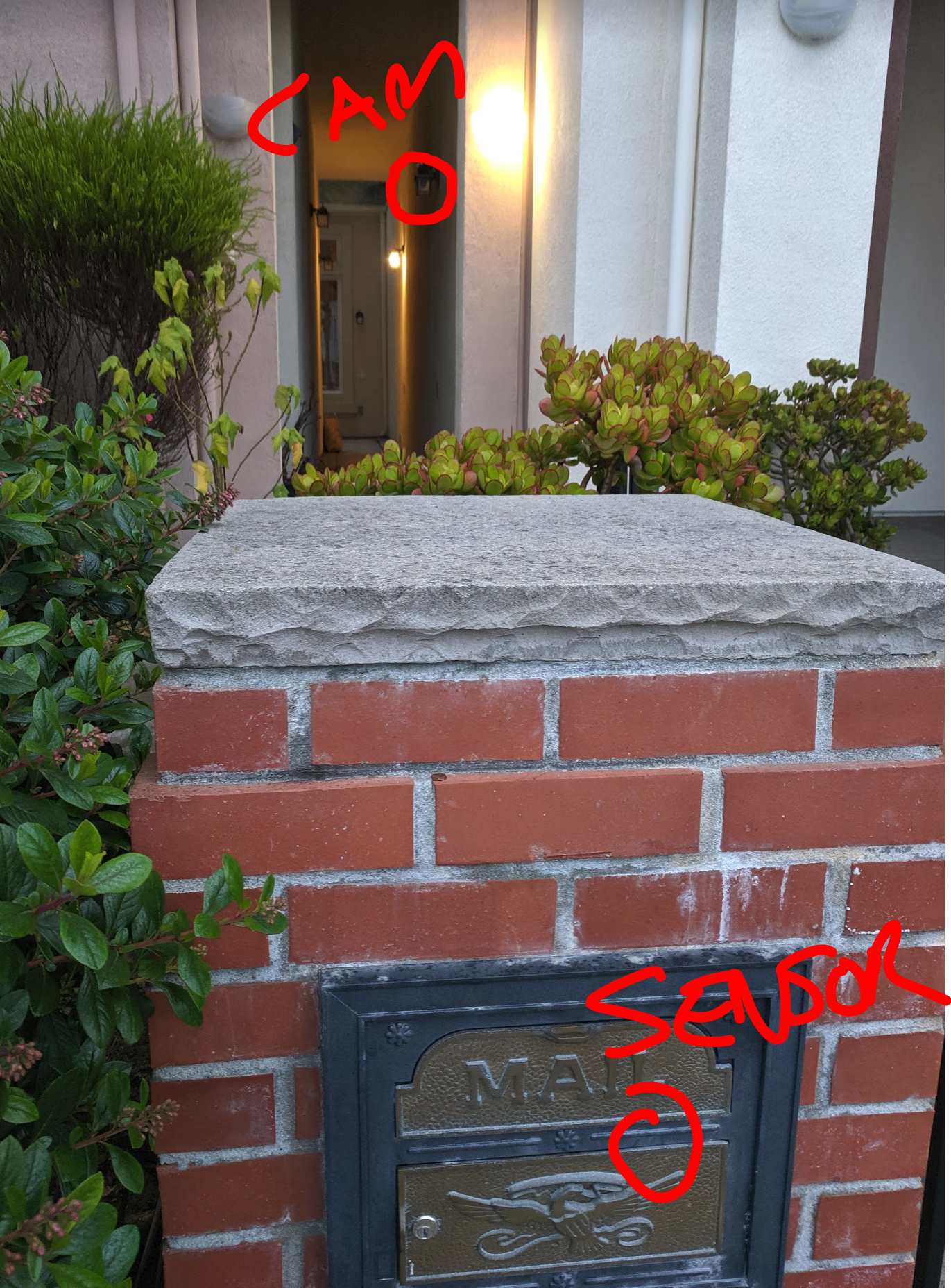

I have a cast aluminum mailbox. I attached the motion senor on the back wall well above the halfway point between the top and bottom. The mailbox is over 75 feet from an indoor Wyze camera. It has not failed to detect the mailbox door opening since it was installed some 2 months ago.

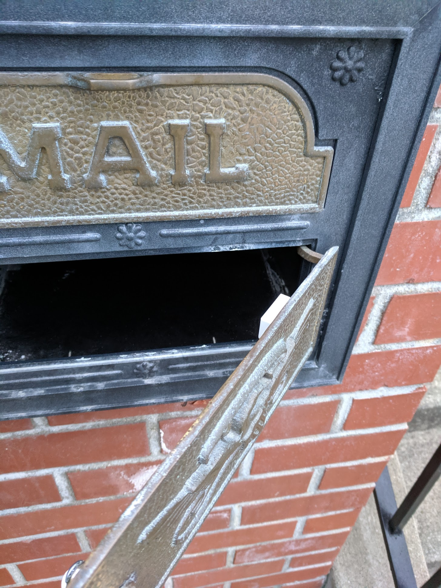

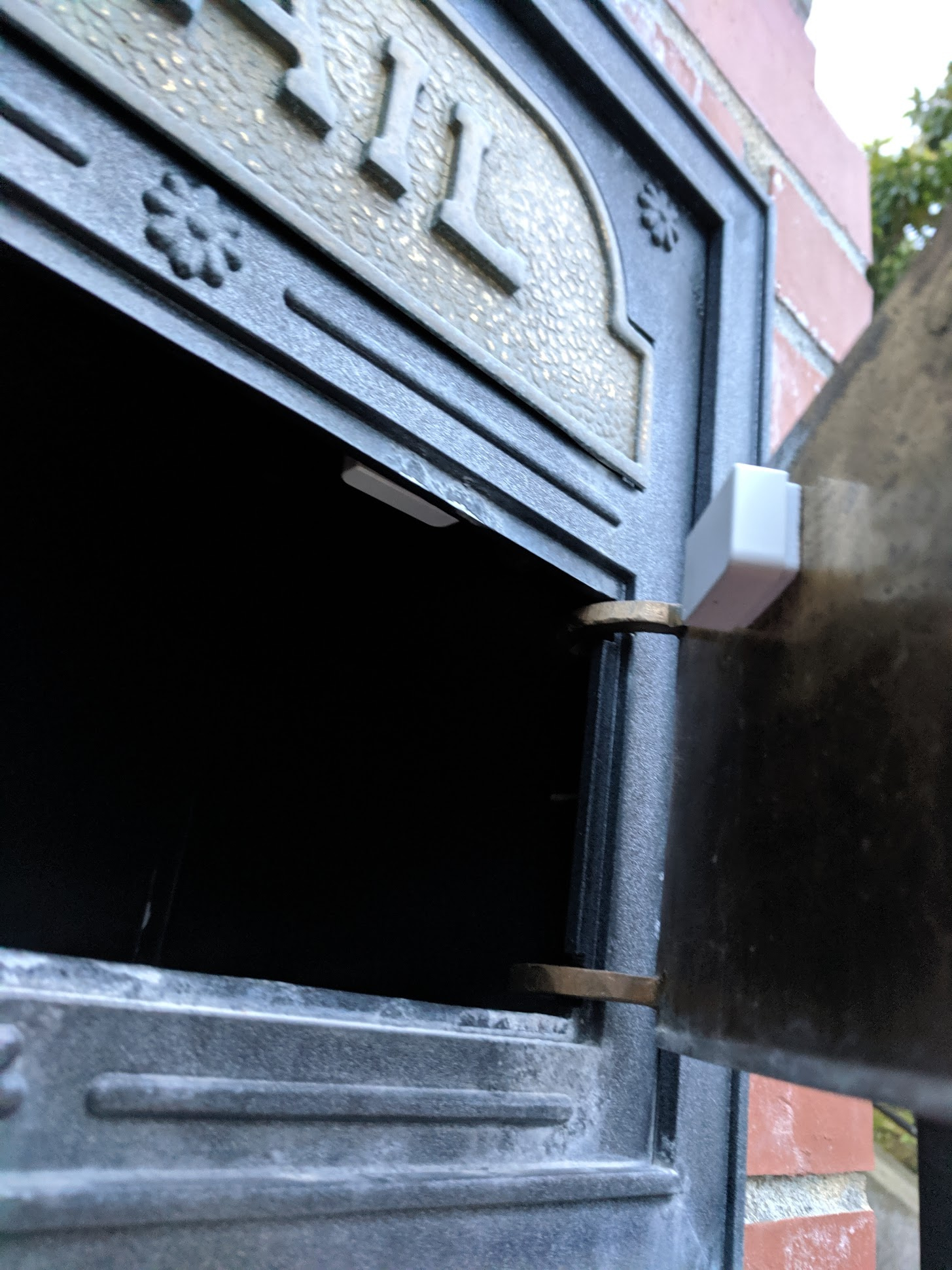

A few photos of how I arranged this:
For your information a foamed PVC plastic was used for the
contact sensor enclosure because it would take wood screws better than the
solid PVC. PCV type for the magnet holder didn’t matter in my case because thru
hole machine screws were used.
Good luck with your project.
Victor Maletic

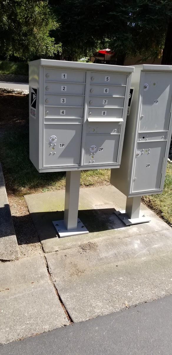

Like Loki, I opted for the motion sensor mounted on the back of the mailbox for my mother and it works great.
I’m curious, what is your mother’s mailbox made of?
It’s one of those large community mailboxes (condo) made of steel. Her mailbox is #2 in the picture.

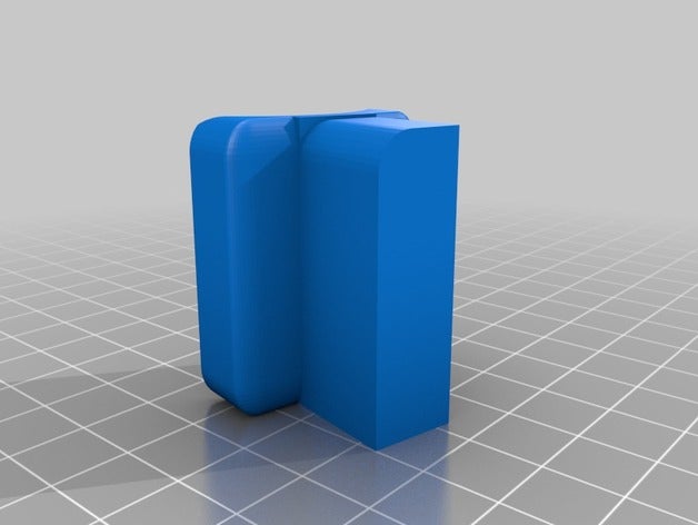

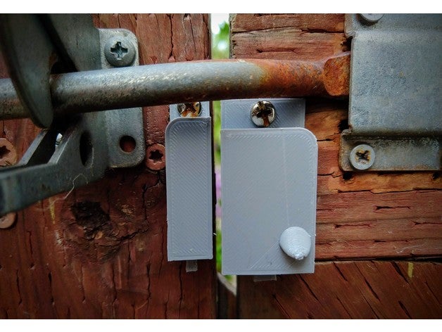

I 3D printed some cases for mine and stuck them on The outside with command strips. My camera is further away then 35 ft and it works great.
Also designed an attachment for my gate sensors by mashing up a couple of designs.
I would like to see some pictures.
Here’s the original gate sensor:
Here’s my remix:
Nicely done nicely implemented, I like both.
Thank you.
