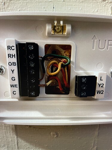

Do you have a photo of your furnace board?
This is mine, wall and furnace. I assume I can just run more furnace wire from the furnace to the board and make this work.
MAybe use G as C but have a jumper at the control board between G and W?
I resolved the issue by running all new 18/5 thermostat wire from the furnace to the wall panel.
