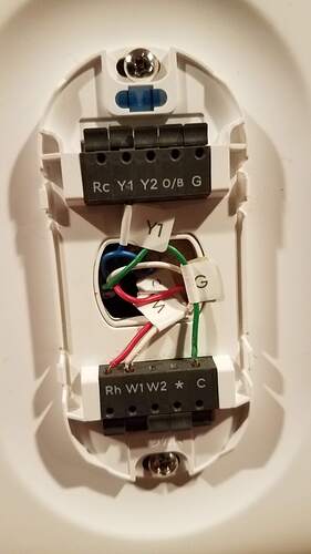

just installed thermostat. I have 4 wires at old stat with red jumper. Installed wyze stat with the C wire adapter. No screen lights up no worky. Spent some time tiring to find info on wiring. Not a lot of support from wyze. Maybe defective, but how do we debug it?

You need a C wire on the thermostat side. I think your G (green) wire will become the C wire on the thermostat side if you use the C wire adapter.
Connect Green to the C terminal on the thermostat back plate.

Ok, I finally got back to try the C to green wire swap. No worky. No light on thermostat. I have 29.8 volts at Y and R terminals. Maybe I should just run a 5 lead wire and connect C at thermostat. I wish Wyze would just state what wires are needed at plate. Power schematic would be nice. I may just have to return this unit and go with a Nest.

In one of your pics, it appears the circuit board that is on your furnace has 5 wires coming off of it. Red, Yellow, Green, White, and Blue. Obviously, the cable colors don’t match with the circuit board color labels
If all 5 of those cables listed in step 1 above are fed to the back of the thermostat, then simply coordinate the appropriate colors.
2)a. In your original thermostat pic, I see 5 cables. Two that are red which correspond to the 2 red on the original thermostat. One is obviously for the “red” slot. The other “red” cable is most likely coming from the “C” slot on the furnace which would help complete the circuit.
2)b. That extra “red” cable going to the old thermostat, can you remove that and plug it into the “C” terminal?
You moved Red wire from Rc to Rh
Move it back to Rc. Wyze does not use Rh.

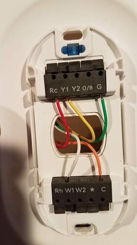

This is due to the C-Wire Adapter. Normally when there is a call for heat, the inducer motor turn on to close the pressure switch, which then opens the gas valve. The IFC has a built in timer to delay the blower while the heat exchanger warms up. The C-Wire Adapter seems to bypass this by applying 24v to G directly activating the blower. Your only real work around is having a new 18/8 or 18/20 Hybrid wire pulled from the furnace to the thermostat and do away with the adapter.

Red to R, White to W, Yellow to Y, Green to G, Blue to C
No change in blower start up by eliminating the C-adapter. Got new wire installed. ran 5 wires one as C. The blower will start when stat calls for heat. I guess it really is a bug in the software. I took pictures of new wire hookup. FYI: The 2 lower wires (yW & oR) at the board are connected to a humidifier.
The cabling looks good.
